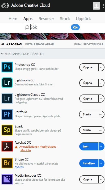

On my mac a test version of Acrobat DC won't uninstall

Hello I managed to uninstall the Acrobat DC test version finally. What I needed to do was to kill all Adobe processes and then I tried again and the Apps uninstaller worked
