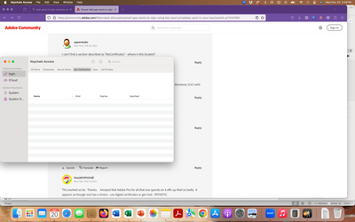

Community Beginner ,
Nov 20, 2024 Nov 20, 2024
I did what Huma5DDI suggested and delete the 3 certificates that were there. Two of them were dated the same as the date the problem started. Yippee, it worked! Here is where I found certificates in the Keychain Access area.
