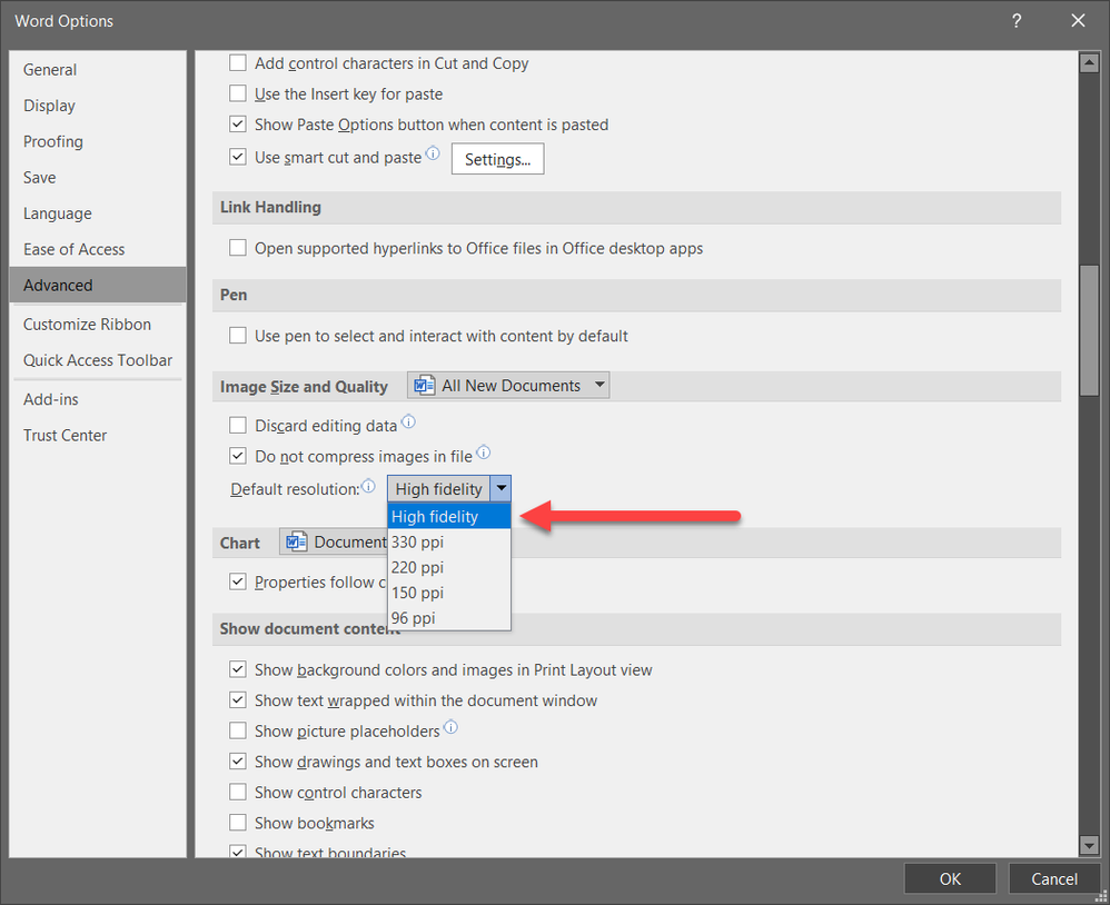

It goes under GIGO, garbage in, garbage out! The original document appears to have been printed on a daisywheel, dot matrix, or low resolution inkjet printer typical of the time period (1981) and then photocopied!
Further analyzing the PDF file provided, to make matters worse, it appears to be a PDF file created by placing images into a Microsoft Word document and using Microsoft's own PDF creation which is notoriously problematic. That is probably the source of the images being 200-225 dpi and in fuzzy-wuzzy JPEG format. Microsoft Word has preferences as to what resolution to store placed images at. Always us the High fidelity resolution setting:
Furthermore, use Acrobat's Save as Adobe PDF PDFMaker facility to create PDF from Word, not Microsoft's! Create special options that result in images not being downsampled and ZIP-compressed within the PDF file. You absolutely don't want JPEG or even JPEG2000 for this purpose.
However, if there is a way for you to get the original scan images and ascertain whether they are significantly higher resolution (and preferably not JPEG), I would suggest creating a PDF file directly from such images and trying OCR in Acrobat from there. Even better, if you have the original paper, I would suggest totally rescanning at 600 dpi into lossless TIFF format and for pages with issues, doing some edits in Photoshop.

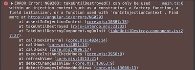

I realise this thread is a few years old.
In comparison to Adobe, this is an amazing piece of OCR software. It puts Adobe OCR, to shame.
I wanted to use Google OCR, but it is only an API service, which seems a bit bananas 🍌
I will show you what it did to the following image:
> ERROR Error: NG0203: takeUntilDestroyed () can only be used main.ts:6
within an injection context such as a constructor, a factory function, a
field initializer, or a function used with `runInInjectionContext` . Find
more at https://angular.io/errors/NG0203
at assertInInjection Context (core.mjs:10367:15)
at takeUntilDestroyed (rxjs-interop.mjs:23:33)
at
7:27)
TakeUntilDestroyComponent.ngOnInit (takeUntilDestroy.component.ts:2
at callHookInternal (core.mjs:4024:14)
at callHook (core.mjs:4051:13)
at callHooks (core.mjs:4006:17)
at executeInitAnd CheckHooks (core.mjs:3956:9)
at refreshView (core.mjs:13513:21)
at detectChangesInView (core.mjs:13663:9)
at detectChangesInEmbedded Views (core.mjs:13606:13)
When I tried this with Adobe, it couldn't extract any text at all and when Adobe OCR does extract text, it adds it to multiple text boxes, littered all over the place, whereas the Scanshot Document Scanner app just creates a single string of text, with paragraph breaks in the correct places.
