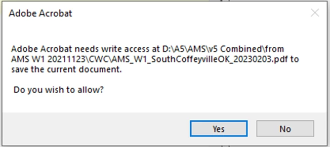

Previously the file was saved.  Now, the popup below is shown
Is there a way to have this automatically allowed so the user is not involved?  This popup displays if the pdfname file exists or not.

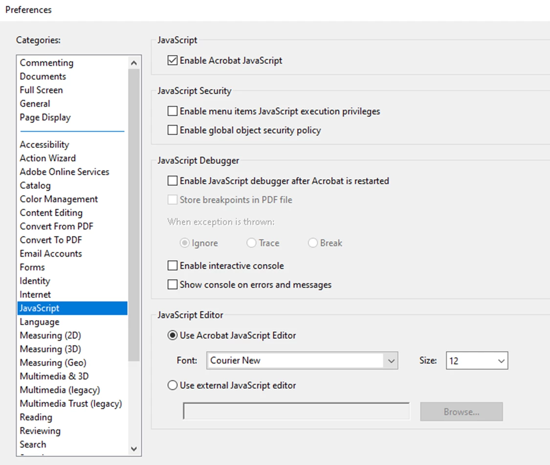

These are my settings.
If I click on the popup, the process continues successfully.  I just need to get rid of the UI interaction.

Disable everything that's selected under the "Security (Enhanced)" tab.
