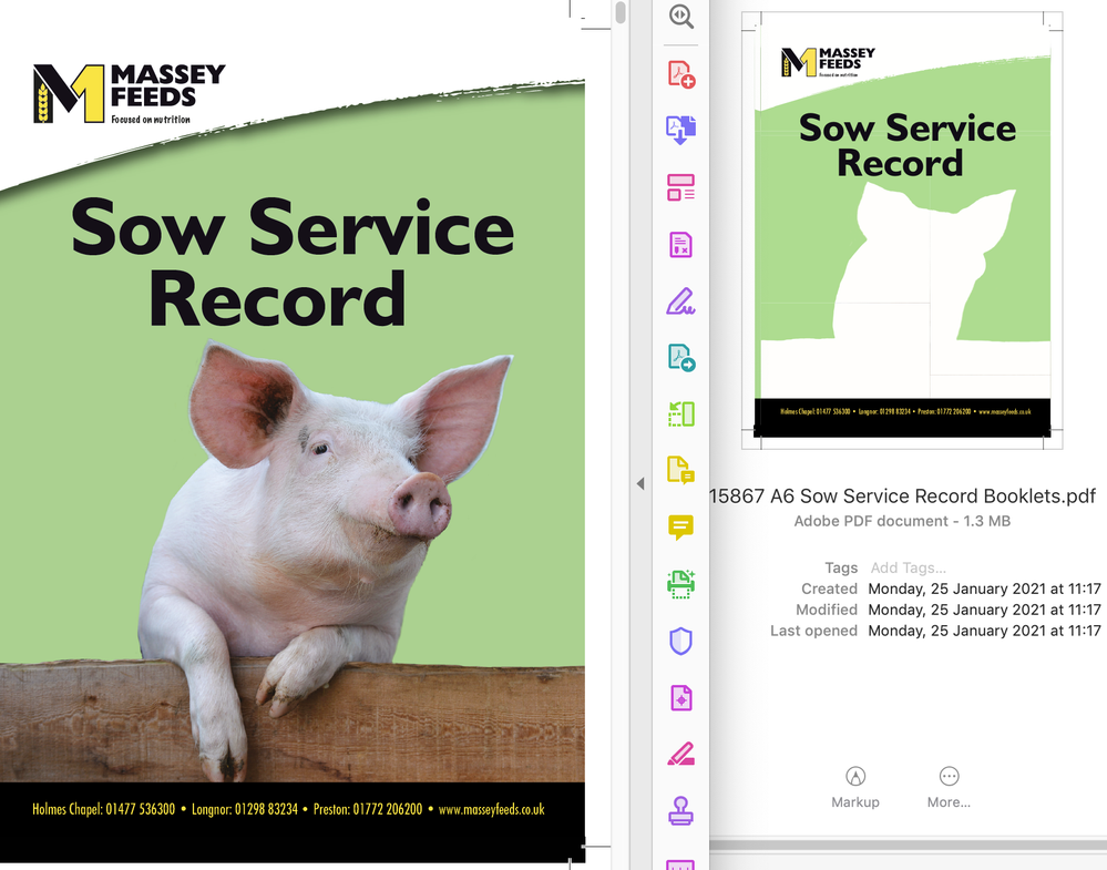

I am trying to resolve an issue for white overprint, I have been supplied a PDF with over-print issue. It prints like it shows on the right. As I only have this a PDF I need to know to fix this in acrobat if anyone can help please?

Are you sure this is a problem of, specifically, white overprint? Why do you say so?
For example, it might be said that it is a problem with the image not printing.
Does the file show any spot colours? What do you see in output preview?

Ok, thanks, I now know what's going on. (For what it's worth, this is not a "white overprint" issue. That's a nasty thing too, but the effect is that white things disappear, not that other things disappear).

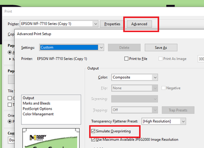

This PDF has indeed been made in such a way that it is only correct if overprint is used (as on a printing press), or simulated. If you just want to print it yourself, you can just turn on Overprint Preview when you print from Acrobat Pro, using the Advanced settings in Acrobat's Print dialog. These screen shots are from Windows, because I have no printers in any of my Macs, but it hopefully will look the same.
