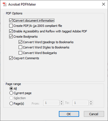

Explorer ,
May 26, 2022 May 26, 2022
The PC is running Windows 10 build 21H2.
Note that I had upgraded two identical PC's, previously running Acrobat XI Standard.  Both PC's had XI removed and Acrobat DC Pro installed as part of a Business License.  With both PC's, this PDFMaker option worked when XI Std was installed.  After the DC Pro upgrade, one PC works fine, but this one does not.
Here is a view of the options listed in the File menu "Save as Adobe PDF":
The options under Preferences in the toolbar show similar defaults.
I have cleared out all the settings and tested it from the File menu option - no change.
I have cleared out all the settings in the Preferences option for the tabs - Security, Word and Bookmark.  No change.
I have also gone into the Advanced option in Preferences and changed the compatibility option from version 7.0 to 5.0 (suggested by a different post) - No change.
Does Acrobat write information to any log file that may provide some clues why this is not working on this PC?
