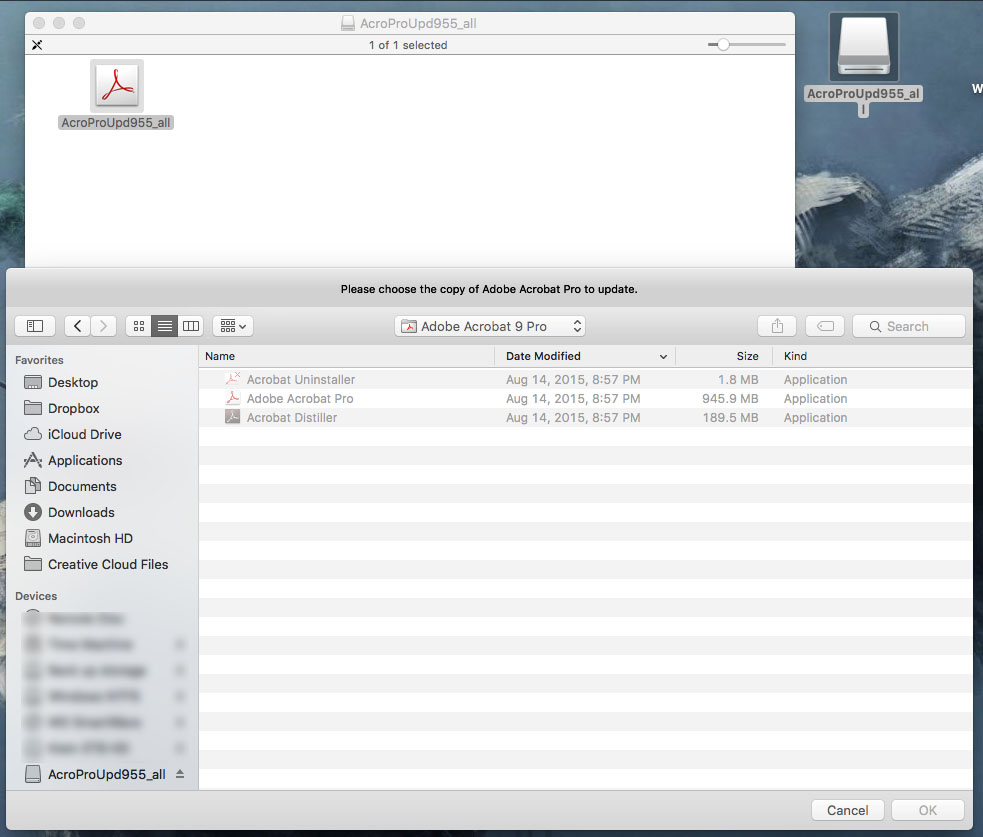

After much effort through Chat support, I received an update file enabling Acrobat 9 Pro to update from 9.0 to 9.5.5. However when I open the .dmg file, the Acrobat application is greyed out so I am not able to complete the install. Any help would be appreciated.

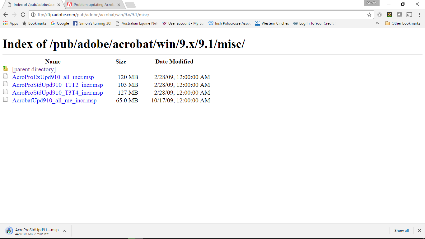

Well I finally got my Adobe Acrobat 9 Pro on a new install of Windows 10 to get current and checking for updates.   AS has been pointed out above in this thread, I had to download the updates one at a time and unfortunately for me, my "check for updates" did not start working until I slugged it out downloading them one at a time until after I got version 9.40 installed.    Thanks to all who posted and for those that come after, here is Windows link again (and be sure you pick your correct version ie pro, extended, standard etc. from the sub menus as you start downloading each link)   BTW Adobe, I have told all who I contacted; on the phone, on the live chat, that the support they were providing was not appropriate, Adobe programs are darn expensive and if they give up on supporting their products, why in the heck should we continue to support them, when its time to shop for software again, given any choice......You can do better Adobe....
ftp://ftp.adobe.com/pub/adobe/acrobat/win/9.x/

October 10, 2016
We have to deduce what Adobe meant, but AcroProExUpd910_all_incr is likely to be Acrobat Pro Extended, a different product. While ProStd suggests Pro and Standard. I don't know what the T1T2 means.

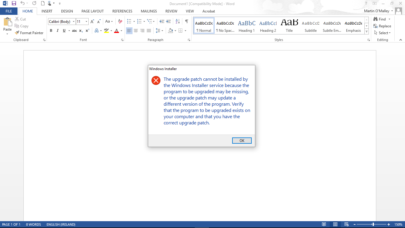

October 10, 2016
I got the same result as Martin.  I have Adobe Acrobat Pro 9.  I downloaded the first updated named; AcroProExUpd910_all_incr and got the exact same error pop up Martin described...

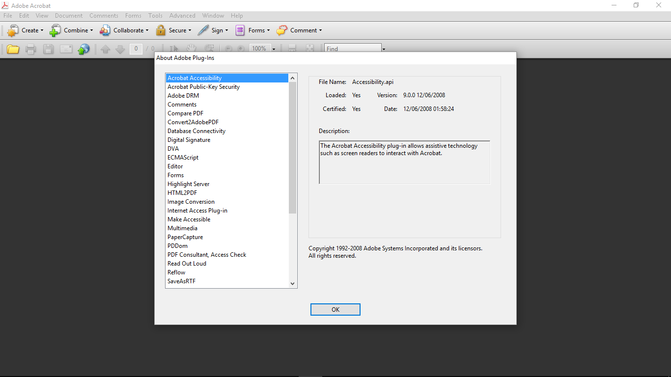

October 10, 2016
And my Acrobat Pro is working, I use it but I had to reinstall it due to reinstallation of windows...but Adobe site download is the updated version of the program, as it was when I installed it back in 2010.....
October 10, 2016
Well, what exact version do you have now, and what is the exact name of the patch file you downloaded?

Sorry, WINDOWS is here ftp://ftp.adobe.com/pub/adobe/acrobat/win/9.x/  and you will certainly need to do each update in turn. On the plus side you can ignore the demand to reboot until after the last update. Archive the updates, they won't be around forever.
October 10, 2016
Thank you for the link.
However, I keep getting the following message and I know that the programme is installed.
Any advice on how to get around this issue
October 10, 2016
Same links, I think. Try 9.5.5. If it doesn't work, do 9.1.0 and every one in between.

Acrobat 9 updates for Mac are available here: ftp://ftp.adobe.com/pub/adobe/acrobat/mac/9.x/
