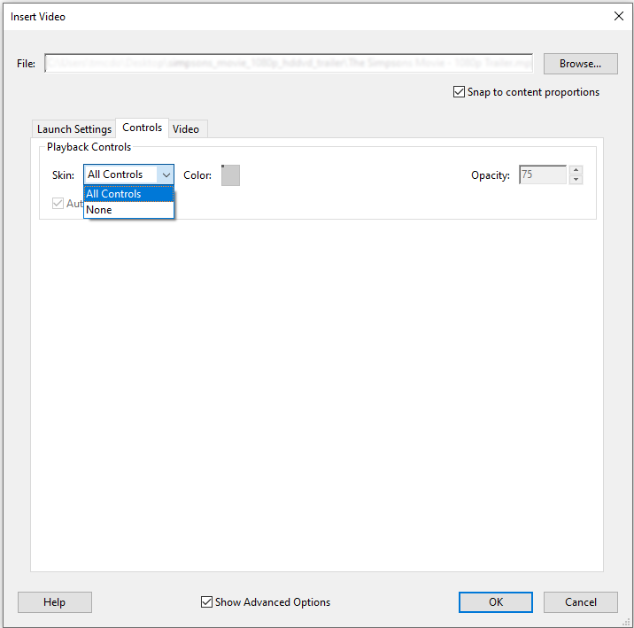

When I try to embed a video into Adobe Acrobat Pro DC, I don't have the same choices available as I used to have in Adobe Acrobat - importantly, those involving Controls. In the Controls dialog window, the only choices are All Controls and None, unlike earlier versions where the only one I needed was Play (the others would hide the subtitles on my videos). Furthermore the choices of Color, and Opacity, and Autohide controls (which are important to me) are grayed out. So when the video opens, it plays immediately, then stops. That's it. All the controls are hidden, per the default 'Autohide', which was grayed out. Instead of being able to re-play the video as used to be possible by pressing 'Play', all a reader can do at that point is just hit 'X' to close it. These are MP4 videos.

Having the same issue.  I would add that when authoring in Acrobat DC/Windows 10 (yes, it's up-to-date), the Contols tab of the Insert Videos panel no longer offers the options it used to.  It just offers "All controls" or "None".  "Auto-hide" is checked and grayed so can't be unchecked. Color and Opacity are also grayed and not responsive. And even when you choose "All controls," the inserted video has none. You can start play by clicking on it, but you can't stop it. (And for some users, clicking the video causes freezes and crashes.)
Screengrab below in case it helps.
Thanks for looking into this.  (BTW, there are other threads where this same problem is discussed.)
