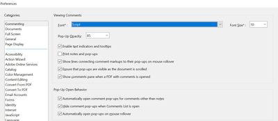

Thanks for sharing the screenshot. That gives better clarity to the whole scenario.
It looks like you have changed the Commenting Font style to Symbol, and now the dropdown menu option is also grayed out.
By any chance, can you click on that small down arrow in the dialog box next to "Symbol"? If not, then try this:
Open Acrobat>Edit>Preferences [Ctrl+K]> Commenting> Viewing Comments >Fonts> change the font from the dialog box>OK

Community Beginner ,
Jul 01, 2022 Jul 01, 2022
Nope. The font type is Tahoma...but Symbol still shows up on the Add Text Comment... 😞
