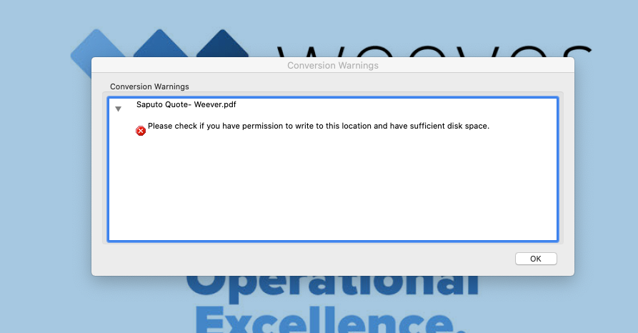

How is this issue marked as "resolved"?
I exported a multi-page PDF from Photoshop, organized the pages in Acrobat, saved it as a PDF (6GB) and then went to save as an optimized file.

I had the same problem. The issue only occured when my file got larger than 5 GB. The same permissions/disk space error message, in spite of having plenty of space and no permission issues with smaller files.
THE SOLUTION
This is what worked for me:
  1. In Finder, I CTRL-clicked on the original PDF file name and chose "Open With" -->
  2. then picked the "Save As AdobePDF.app" from teh dropdown -->
  3. elected "Smallest File Size" in the next pop-up -->
  4. and voilà! The file size went from 5.21GB to 23.3 MB!
    Hope it works for you, too. Best of luck!
