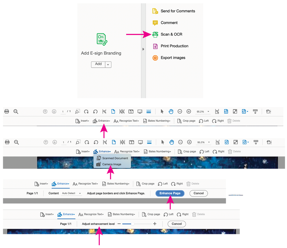

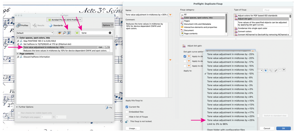

While an image editor is the best tool for this job, there are some Acrobat tools that can do a passable job. First go to Tools> Scan & OCR> Enhance> Camera Image> Enhance> Adjust level (+), this will remove most of the background. You can then use a preflight fixup to darken the midtones. Go to Tools> Print Production> Preflight> Fixups, type "tone" in the search window, select the preflight shown in the attached screen shot and duplicate it from the "Options" fly out menu (you can't edit the original preflight), edit the duplicate preflight and select one of the midtone correction options, apply the preflight by clicking "fix" at the bottom of the window.

See attached screen shot, save pdf after adjusting levels.
