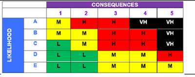

I have this risk calculation matrix (Table below) at work that I need to automate
Briefly, the risk can be calculated by Likelihood and the consequences of an hazard.
e.g. if a user select one cell ("Likelihood") with D and selects the second cell ("Consequences") with 3. Then I want the third cell showing the risk calculated to be M.
The problem is there are so many combinations here, so I don't know what to do.
Anyone can help with the JavaScript of this?

Is there a logic behind it, or is it pretty much arbitrary what the result is for each combination?
If the latter you'll need to specify it for each combination in your code, using a set of if-else conditions, or a 2D array, as was suggested.
