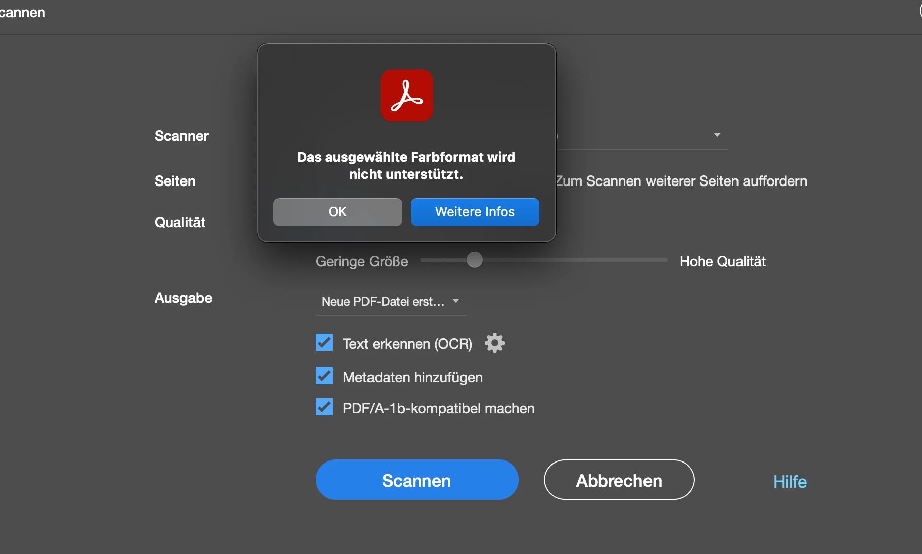

Using the Apple or HP Tools for scanning works pretty good with the above configuration. Scanning a document with 200dpi/color with Acrobat Pro always results in an error message and sometimes freeze:
The problem was already present under MacOS Monterey. Due to the fact that the combination is well working with other software, it is probably the trouble with Apple´s "new" Silicon architecture... When can we expect a fix? It is uncomfortable spending lots of money for a professional software when even a basic OS tool results in better performance...

I've been scanning on Macs for OCR purposes for over 30 years now. Some time back, Apple chose to no longer rely upon TWAIN, a linkage software used to connect two different applications. So, if you have an HP scanner and want to scan from Acrobat, TWAIN would allow that to happen. It still can be done on PCs, but their approach is to provide convenience over any chance of virus attack. Jobs felt differently, and now there is no Flash.
What Apple does provide is the application "Image Capture." It's a multi-tool application that lets you ingest images from your camera to scanning. For the former, it is not all that much different than simply dragging the images from a camera card to your computer. For the latter, it also is very bare bones. The dynamic range that IC is able to capture is maybe 6-bit, much less than a JPG image can support (8-bit). And trying to enhance an image or a document is a fool's errand.
What I STRONGLY recommend is for you to use your scanner's software. Do not try to scan from within Acrobat; it's just not worth it. What I do, and have been doing for over 20 years now with no issues, is scan and save the TIF format images to a folder on your desktop. Then, once complete, drag the image(s) to the Acrobat icon in your Dock. You will be asked if you want to combine these into a single document; click "yes." If you scanned to a TIF document, then Acrobat will also do the OCR conversion (if you scan to JPG or PNG, you will have to do that as a separate step after the PDF is created).

Thank you, Gary, for your very valuable hints! It should be also possible to scan it with e.g. HP-Scan or even the Apple preview app into a PDF and then process this by Acrobat (if this makes any sense...except if you want to edit the document)? But a pity to use 2 programs to create one PDF....

Not quite. Anything you do from within the Mac will use that same dreadful program, Image Capture. Your only chance to get away from that is to use the software that came with the scanner. Although, if you've had that software for any time, it's probably wise to go to the manufacturer's site and see if there are any updates.
