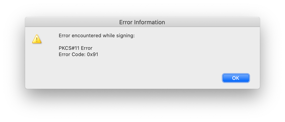

Signing with PostSuisseID on macOS Acrobat worked under macOS High Sierra, but not any more after upgrading to macOS Catalina.
The signing dialog appears in Acrobat (including password requests), but at the end of the process, the error message "PKCS#11 Error - Error Code: 0x91" appears (see screen below). The file is written, but without a signature.

Hi Janes
I do have the same problem - but WITHOUT updating to macOS Catalina. (I am currently running macOS Mojave, 10.14.6.)
However, the siginig functionallity of Adobe Acrobat (same version as yours) stopped working after updating Acrobat...
(As a work around, I currently use the tool of our government... https://www.e-service.admin.ch/wiki/display/openegovdoc/LocalSigner+Download - but this is NOT a long-term solution.)
If you find a way to fix this, please post it here. I'll do so as well.

Hi OSaa,
Acrobat with SuisseID (and with hardware tokens in general) appears to be quite tricky, I had some problemes earlier (see my earlier post), and with help from SwissSign and Adobe support I got it finally up and running under High Sierra. My learnings:
It looks like some background processes die if you are too long in the sleep mode with Acrobat open.
As a digital user, I am currently also using LocalSigner as a fallback.
I have notified SwissSign support and sent them the link to this post; according to their feedback they are working on it.
