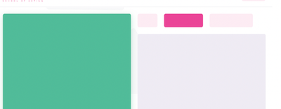

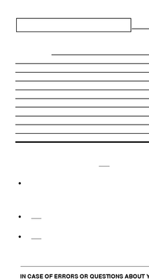

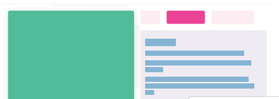

New Here ,
Mar 14, 2025 Mar 14, 2025
Some PDF files. Here are the screen shots  - 1st one is the statement. 2 & 3 are PDF documents. I can highlight the text area, so it's there but not showing.
They were showing fine a few days ago. Just updated OS (Mac OS Sequioia. 15.3.2. ) to see whether that makes diference, but no.

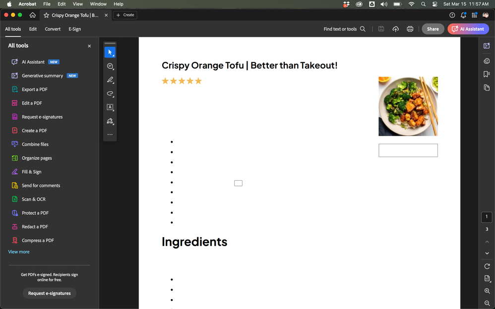

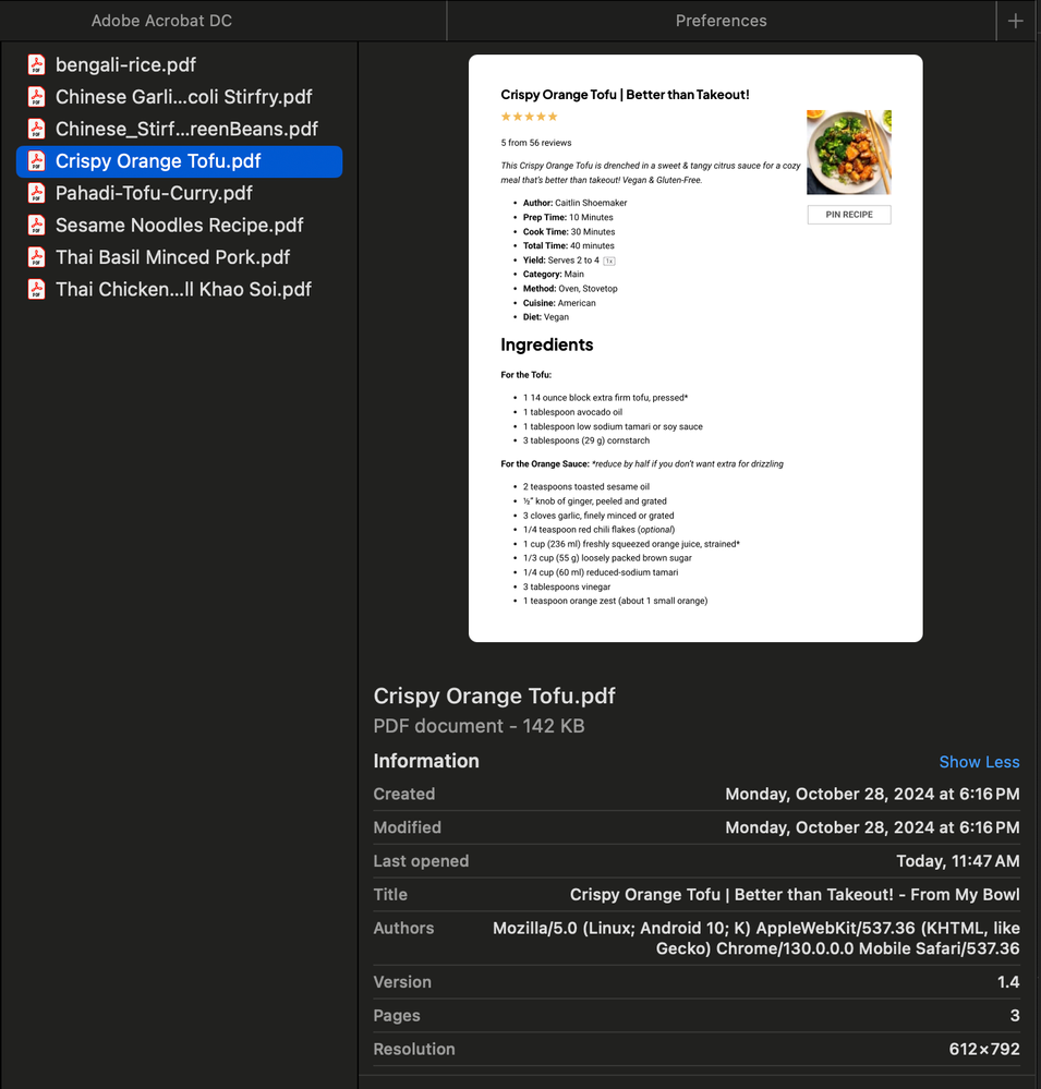

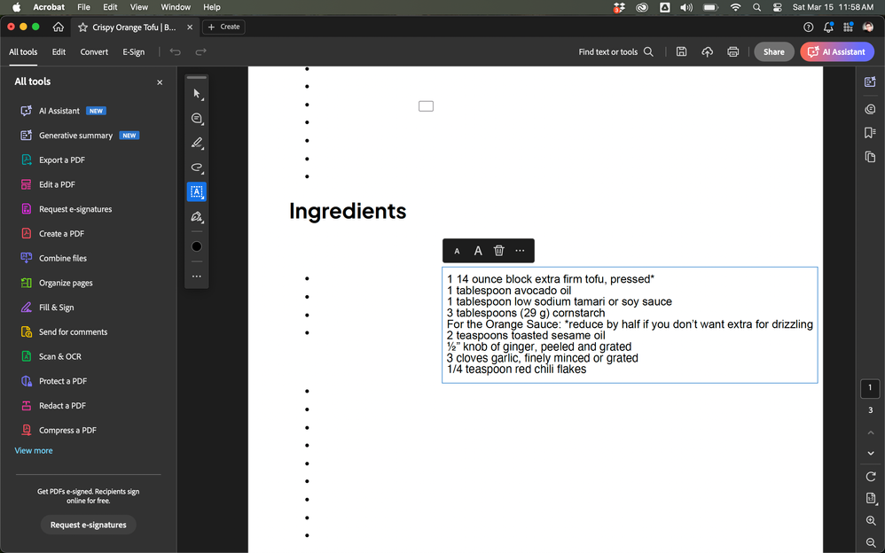

Community Beginner ,
Mar 15, 2025 Mar 15, 2025
Screenshot 2025-03-15 at 11.57.21 AM.pngScreenshot 2025-03-15 at 11.57.29 AM.pngScreenshot 2025-03-15 at 11.58.28 AM.pngScreenshot 2025-03-15 at 11.59.06 AM.pngScreenshot 2025-03-15 at 11.59.46 AM.png
This is now happening to me too. I've uninstalled Acrobat, restarted Mac, deleted the Acrobat preferences file, changed Accessibility options, have gone through all the troubleshooting steps I've found regarding this issue in Community forums, and updated my OS (Sequoia 15.3.2), all to no avail. Preview displays the files. I can open the PDF in Photoshop, and all the info is. there. I can even copy the text from the file in Acrobat, and paste it into the AI search window in Acrobat, but the TEXT WILL NOT DISPLAY in Acrobat. This is not even consistent; some files display in Acrobat and others don't.
