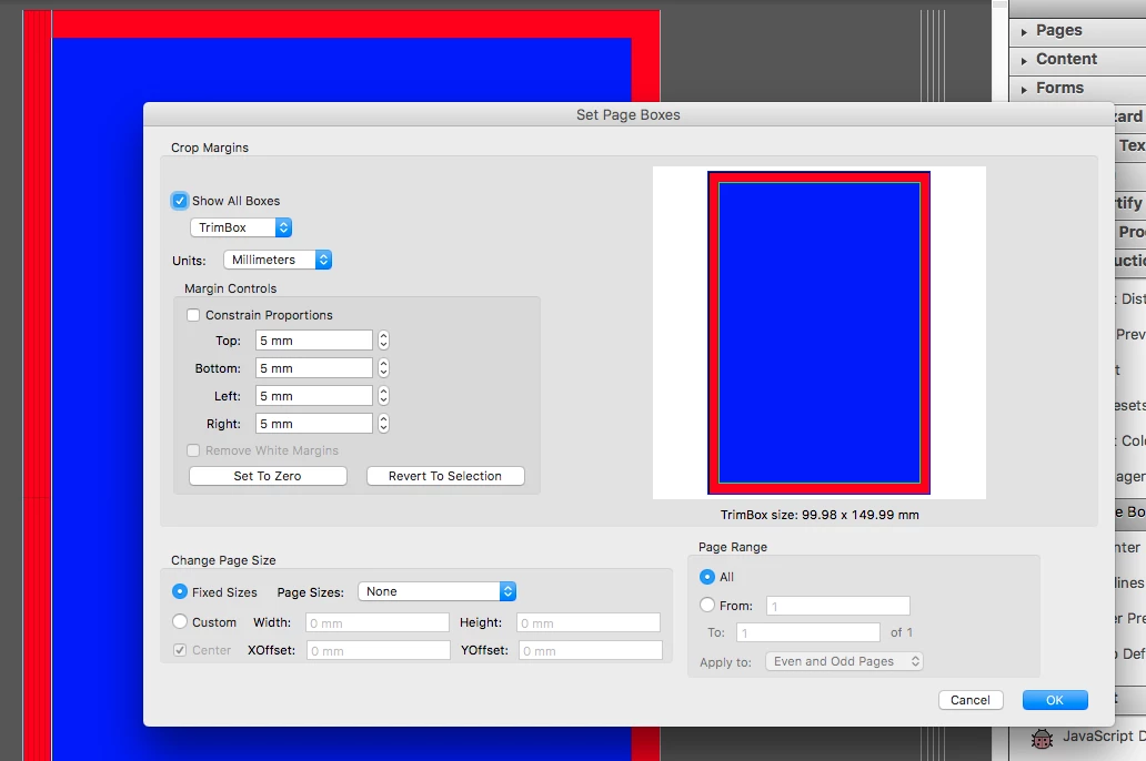

Correct answer Stephen Marsh
Print production tools have what is required:
RGB TIFF image at 11x16cm in size (indicated in red) - but the trim area is to be 10x15cm (indicated in blue):

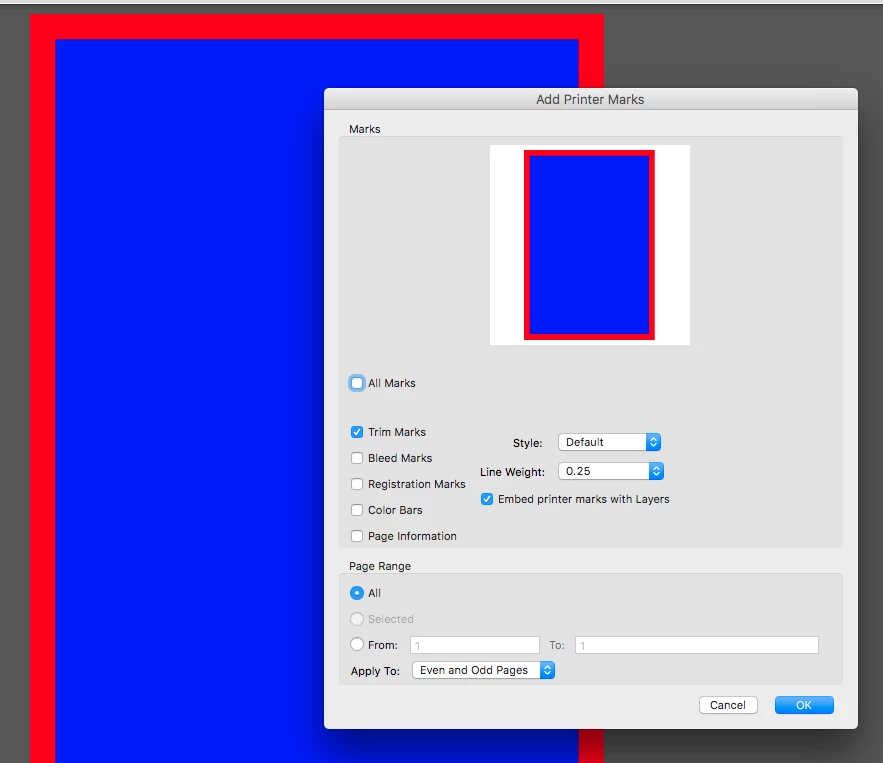

Then add printer marks after the page boxes have been set as required:

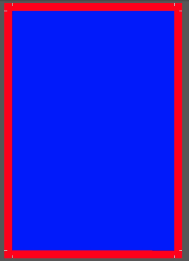

Result:
