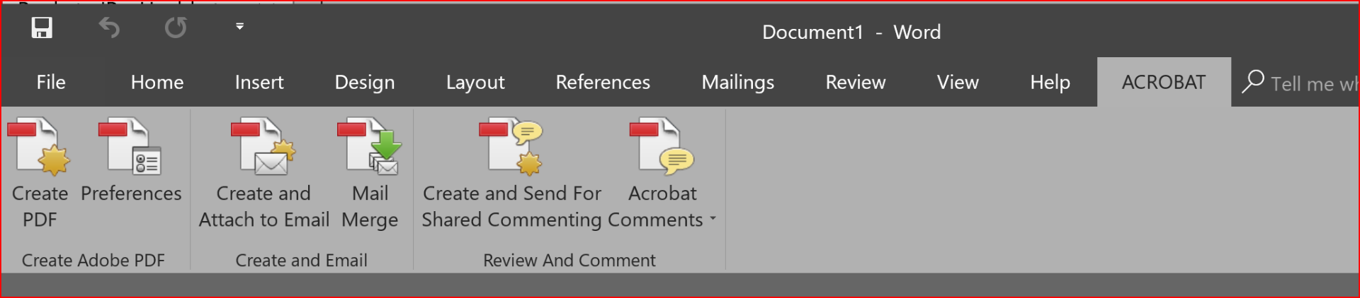

Recently I have noticed that Acrobat XI (11.0.18) cannot create a PDF form from an existing Word Document. This is something that was working previously but is now broken. I receive a popup that says "Unable to find "Adobe PDF" resource files. Do you want to run the installer in reparin mode? Is this something that has broken recently?

So, back to square one, I realized something. When I got this laptop and activated Office with my key, it "apparently" activated the apps from the Microsoft Store, so I was using the store apps and NOT the Office 2016 apps from my Office 2016 DVD. I also noticed that the store apps are 32-bit, not 64-bit. I uninstalled the store apps and then installed Office 2016 x64 on my system and the Adobe plug-in now works just fine.
I don't know if this will apply to anyone else, but I thought I'd share what got it working for me. I'm going to email the rep at Adobe and have him cancel my support case, now that I've got it working. Thanks!
