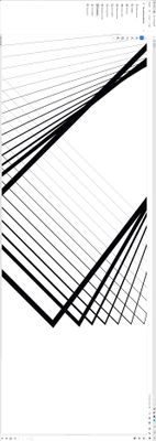

I got a subscription to Acrobat because of the ability to print PDFs across multiple pages but it is not printing my very fine lines correctly. I am using very fine lines in my drawing and when printed they are all wrong.  To see what was going wrong I made a test image of concentric rectangles whose line thickness is getting gradually thinner. It prints OK in Sumatra PDF and if I rasterise the image to 600dpi but Acrobat just prints a black mess. I have spent days trying wvarious printer and viewer settings and searching the internet but I cannot find a solution.
As you can see, the very thin lines are printing as a thick blackness but only with Acrobat.

You're comparing apples to oranges here in terms of the printing technology.
When you print from Acrobat, the object instructions (postscript code) that define the lines are converted to a raster for your particular printer. e.g. if you're printing to a typical 600dpi printer, the smallest line that can be printed can be no thinner than 1 pixel.  One pixel on a 600 dpi printer is equivalent to 0.12 pt stroke. Any line you send that's thinner than that will print at 0.12 pt. So if you have a bunch of them very close to each other like in your sample file, it will easily clump up like that. And depending on how this falls on the printer's fixed raster grid, it can very well cause lines next to each other to be double (2 pixels) thick. There is a routine in Postscript printers that will try and reposition very thin lines so this effect is minimal, but it cannot prevent it, and, this is only on PS printers. Non-PS printers like a typical PCL laser writer does things differently, as do Inkjets using scatter dot technology
Your other two samples are doing things differently... Both of these have converted your thin lines to an image raster that is essentially greyscaling/dithering your lines. There are no actual solid 100% black "lines" at that size. This is also how a scatterdot printer will do it, and if you look at your printed sample, you can see, close-up, it's all random dots.
Now, if you're printing to a high-res imagesetter at a commercial printer with a resolution upwards of 2400 dpi or more, you can produce finer lines. However, conversely, if you print to a 300 dpi printer, it will get worse (minimum .24 pt).
btw: the Enhance Thin Lines is purely a display setting. It does not affect print at all..

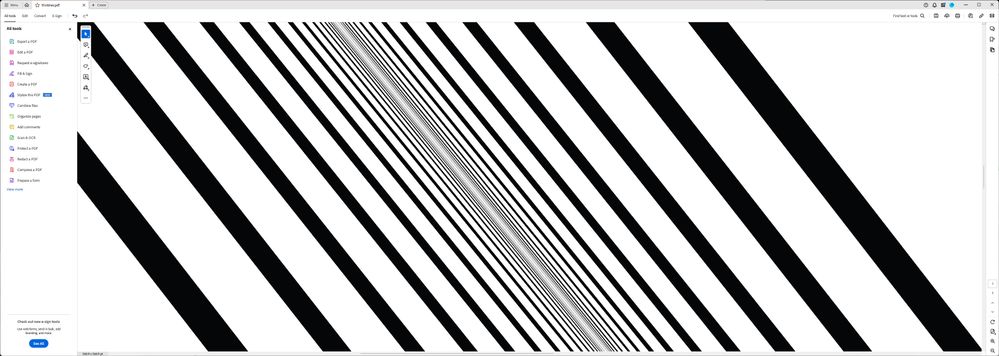

I added a title to each image but they don't seem to have shown up. The first image is a photo of an Acrobat printout. The second is of a Sumatra prinout. The third is a rasterised PNG printout and the fourth is a screen shot of the image in Acrobat.
This image is a photo of all three printouts together.

   Another testfile shows that below a certain thickness the lines actually print thicker than a thicker line. I have set Fix Hairlines threshold in print preproduction to 0 (zero pt) but it seems to ignore that below a certain thickness.
