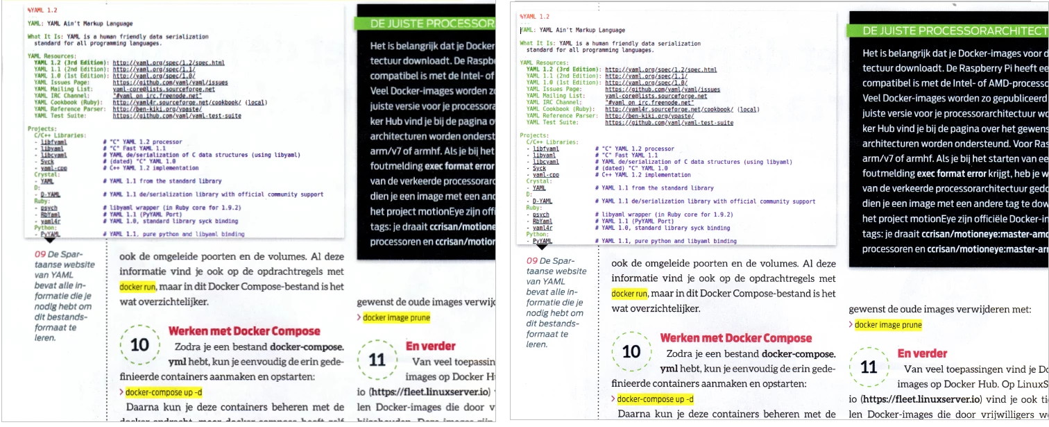

I vainly spent a lot of time on trying to get text of scanned documents look crispy.
For one reason or the other they look blurry.
Attached 3 examples.
It is screenshot of text from Word, saved as a PNG file
1. Left is the screenshot opened by a viewer
2. In the middle is that screenshot converted to PDF - r-click convert to PDF - no, or no significant, loss
3. I printed the PNG file, printout looked fine, and then scanned it - result on the right.
View is 100%, scan is 300dpi, document size A4 (210x297mm) scanner Epson 5620
FWIW I have put some screenshots here.
Hope someone has a clue...
Thanks in advance.

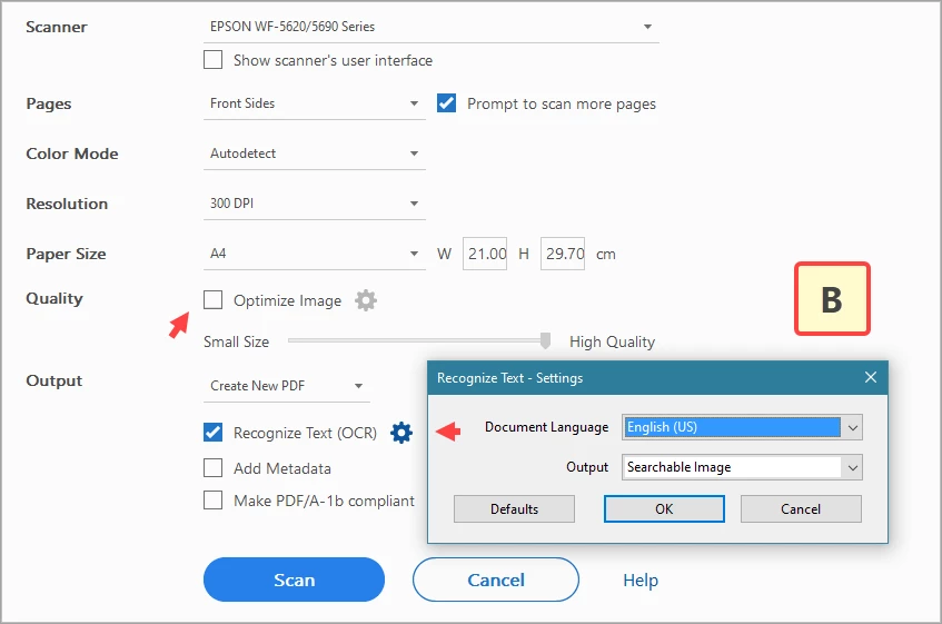

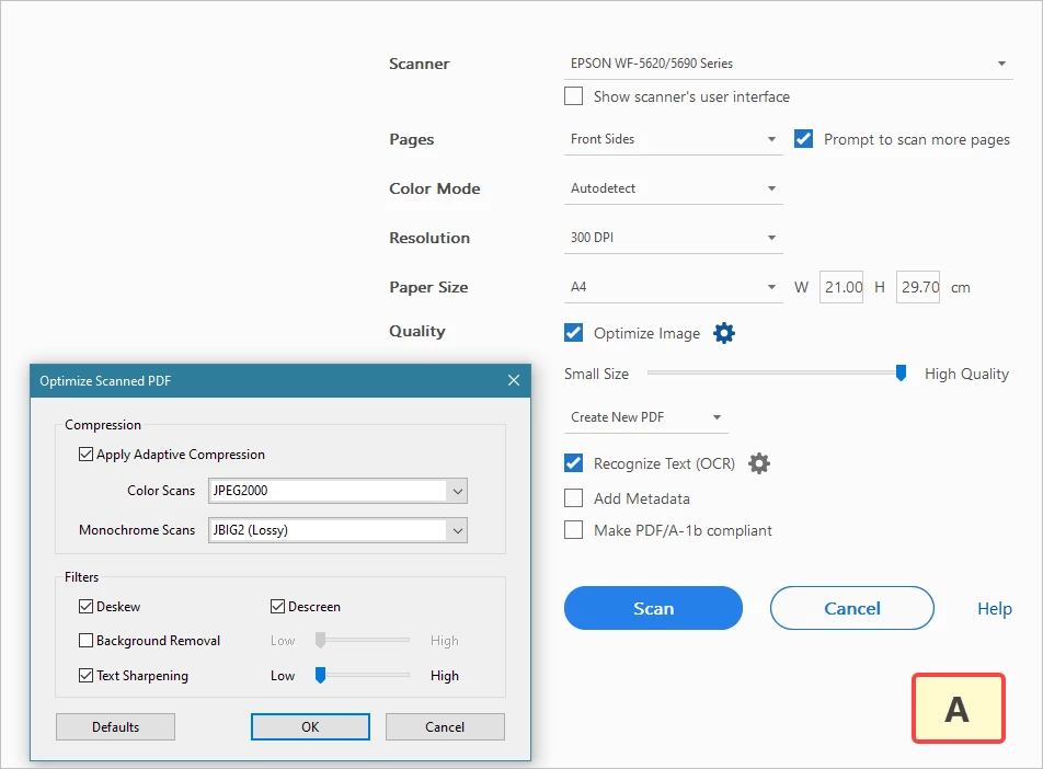

Correct answer adwul62
@gary_sc
For your info, the settings I am scanning with are in the 4th attachment. 300dpi. At that point there is 'Exact Search'
However, I just found out: I should disable optimize... resulting in a fine scan. 
have added them as an attachment as I believe they don't come thru when pasting in this thread.
Pls do check out the attachments.
