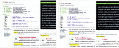

I vainly spent a lot of time on trying to get text of scanned documents look crispy.
For one reason or the other they look blurry.
Attached 3 examples.
It is screenshot of text from Word, saved as a PNG file
1. Left is the screenshot opened by a viewer
2. In the middle is that screenshot converted to PDF - r-click convert to PDF - no, or no significant, loss
3. I printed the PNG file, printout looked fine, and then scanned it - result on the right.
View is 100%, scan is 300dpi, document size A4 (210x297mm) scanner Epson 5620
FWIW I have put some screenshots here.
Hope someone has a clue...
Thanks in advance.

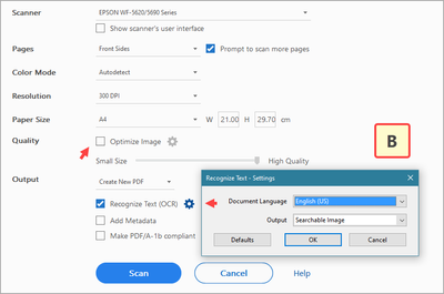

For your info, the settings I am scanning with are in the 4th attachment. 300dpi. At that point there is 'Exact Search'
However, I just found out: I should disable optimize... resulting in a fine scan. 
have added them as an attachment as I believe they don't come thru when pasting in this thread.

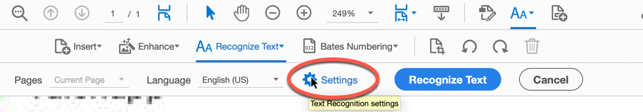

Quick question for you. First, thanks for showing us your application settings, that helps. However, there was one I did not see. If you go to the Settings in OCR, you can get there one way here (there are several ways to this setting)
After opening that up, there are three ways to process the content, see below:
Which of the three ways is your system set to? Whatever it is set to, please try one of the others.
Also, I noticed that in your 3nd screenshot, you show using PNG format. Please try selecting TIF.
Lastly, In the last screenshot, there is an option to use the Scanner's software ("Show Scanner's User Interface.") Can you show what the default settings are when that box is checked?
Pls do check out the attachments.

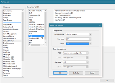

As for PNG converting I have set this as below. I believe this is correct for the best possible results?
I know about TIFF being the best possible format (huge format), however, in my case, considering that usually any image that may require converting, are screenshots only.
Below are the settings.
Again thanks for your help!
