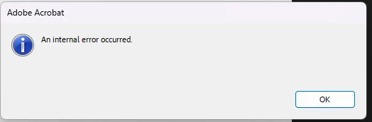

Rolled back to the classic UI and many of the icons were still missing but now when I try to click on anything I saw a warning saying  "an internal error occurred".
For example if I selected 'File' at the top left I would get that error and after selecting Ok the box reappeared. If I selected Ok ~10 times the error box eventually stopped appearing and the File menu would drop down but I was unable to interact with it without it causing the error to reappear.

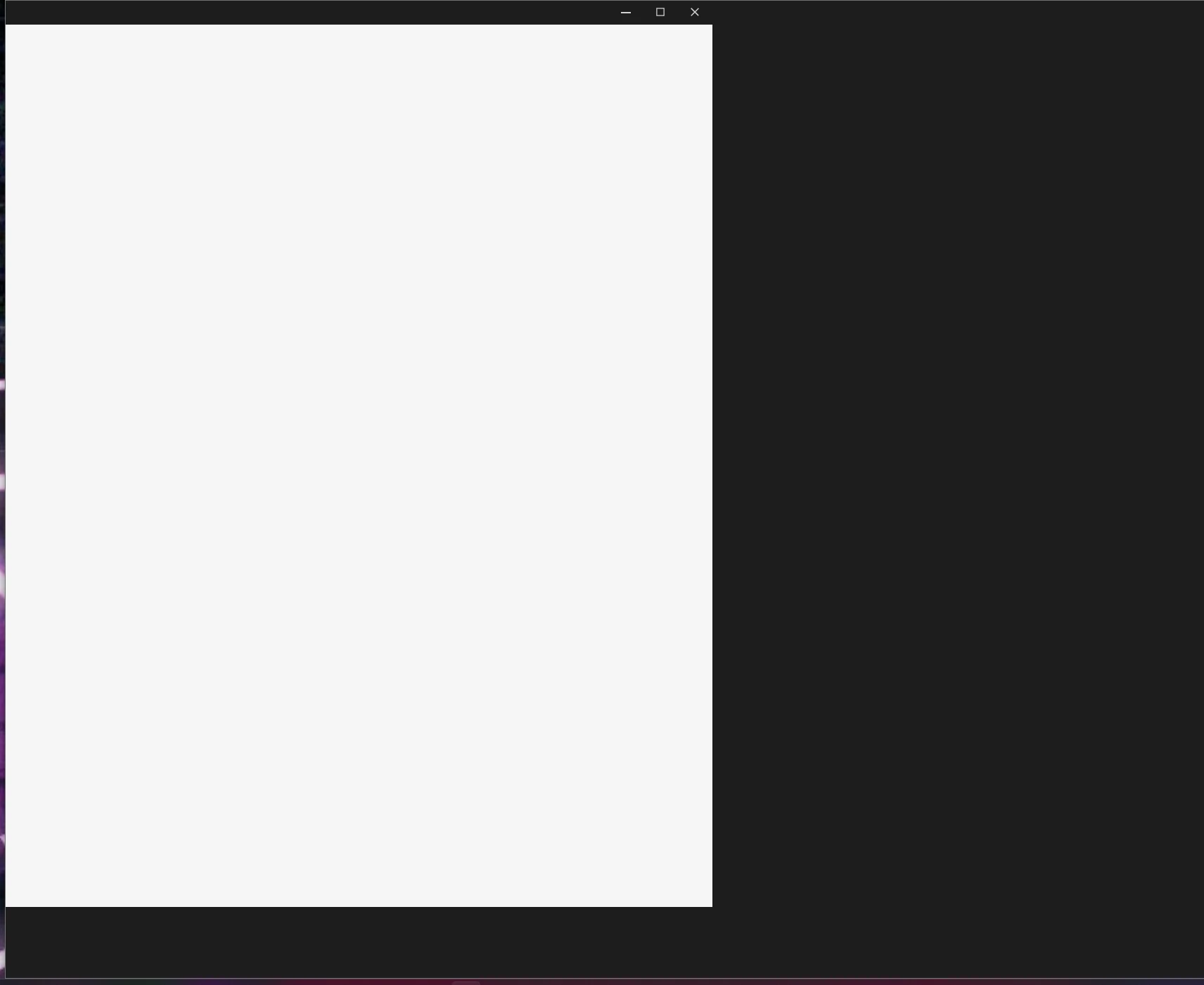

after the re-install Acrobat opens to this page which is mostly a white box

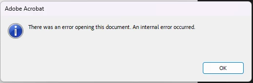

I tried opening a .pdf instead of the app itself to see if maybe opening a file would work but I see this error saying "There was an error opening this document. An internal error occurred."
The attachment is a screen recording of what the experience looks like in the current situation
