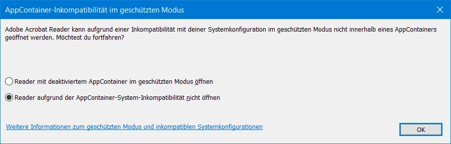

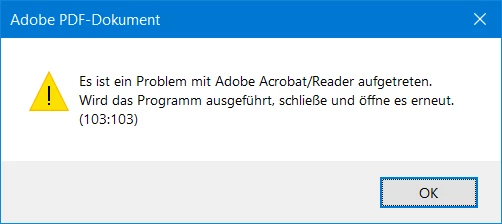

Hi
In our Enterprise we Upgrade Adobe Reader x86 from 25.1.20813.0 to 25.1.20982.0.
After that most but not all client (W10 and W11) can't open Adobe Reader and get the following errors
or in Browser
What should I do to fix this?
CanRFAuthor
December 4, 2025
Dear Support
I rename HKEY_LOCAL_MACHINE\\SOFTWARE\\Policies\\Adobe to Adobe$ so no policies exist until next refresh.
I get AppContainer–Inkompatibilität im geschützten Modus prompt as above.
I set HKEY_LOCAL_MACHINE\\SOFTWARE\\Policies\\Adobe\\Acrobat Reader\\DC\\FeatureLockdown
bProtectedMode: 0
bEnableProtectedModeAppContainer: 0 or 1
I get
bProtectedMode: 1
AdobeReader does not start any more.

AnandSri
December 4, 2025
Hello @CanRF
I hope you are doing well, and thank you for reaching out.
Thanks for sharing the error screenshots and version details. To help you better, could you please confirm the following:
  • Are you using any specific deployment method (e.g., SCCM, Intune, GPO) to push the update to the Reader?
  • Are there any custom security settings or AppLocker/Defender configurations applied in your environment?
  • Can you confirm whether Protected Mode is enabled by default for all users?
  • Does the issue occur only when opening Reader directly, or also when opening PDFs in the browser?
Symptoms (from your screenshots):
  • AppContainer–Inkompatibilität im geschützten Modus prompt
  • “Es ist ein Problem … (103:103)” restart message
These indicate the Reader is failing to start inside AppContainer while Protected Mode is enabled after the upgrade. This is commonly due to endpoint security or policy conflicts
Suggestions:
1) Policy change (pilot ring first):
Disable AppContainer but keep Protected Mode ON via Group Policy/registry.
2) Endpoint security check (if you must keep AppContainer ON):
Add exceptions or adjust Exploit Protection for Acrobat/Reader, AcroCEF, and AdobeCollabSync in your EDR/AV
See this article for more information: https://adobe.ly/4pRUhfa
Anand Sri.
CanRFAuthor
December 4, 2025
Hi AnandSri
Thanks for your replay.
    I create an admin Install Point and the client take the update at next boot. This works for the last 10 years well.
  • Are there any custom security settings custom security settings or AppLocker/Defender or AppLocker/Defender configurations applied in your environment?
    There are lots of custom security settings and AppLocker and Defender in our environment. This as before.
    Protected Mode is enabled by GPO.
    In both cases. On Message is when opening Reader directly and the other when opening PDFs in the browser.
For the last 10 years it works fine in our environment. Rollback to 25.1.20813.0 works fine in our environment
Suggestions:
  I find the info under Preference Reference for Acrobat and Adobe Reader so I will test
  I will test
Thanks for more explanations.
