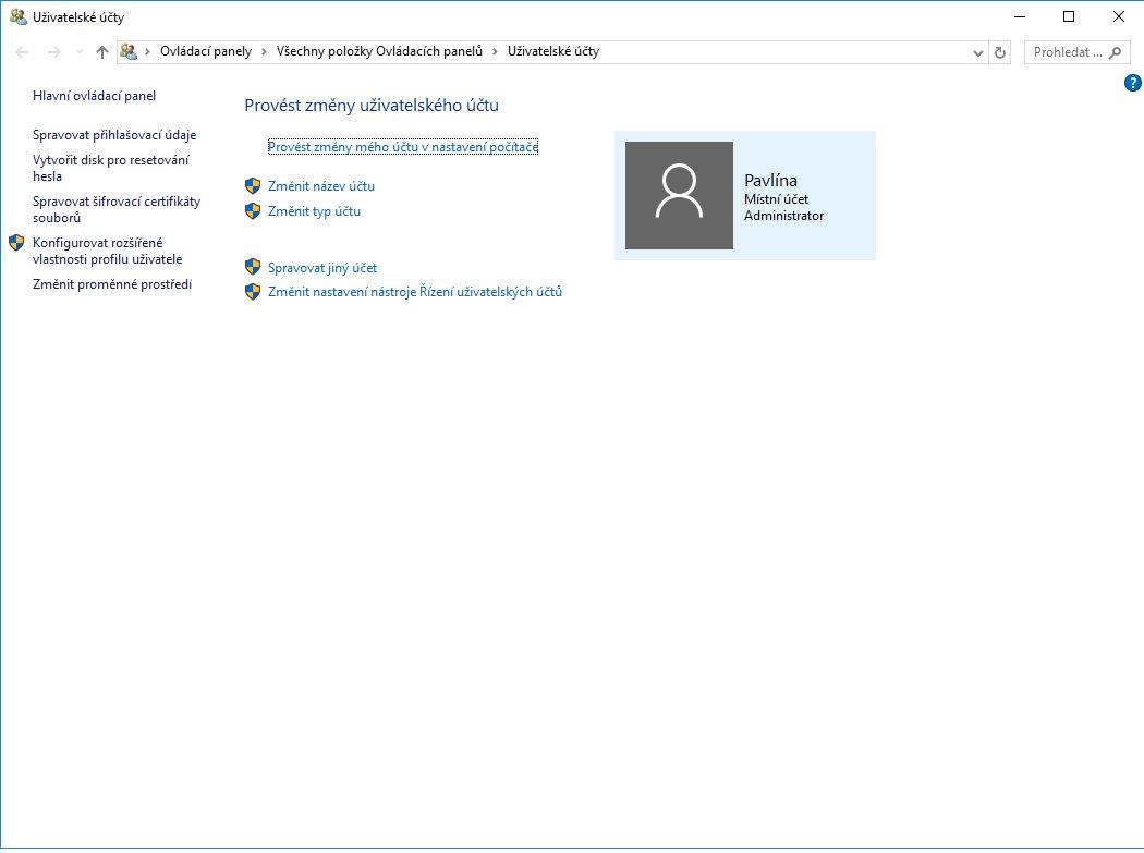

Community Beginner ,
Apr 12, 2017 Apr 12, 2017
The client has administrator account, and still it cant be disabled.
Interesting thing is, that if i run Reader as administrator, the program wont show up, but when i look to task manager, there is proces with adobe reader DC.
Sorry, my mistake, as administrator, i can run the program, but when i want to send mail, the adobe reader gets stuck.
In Picture im sending administrator acc, there is local user, no AD and domain.
