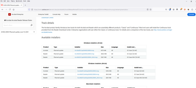

I have tried the MUI downloads:-
AcroRdrDCUpd2400220854_MUI.msp
AcroRdrDCx64Upd2400220854_MUI.msp
But they fail, in the same way as my first downloads from Amal's link:-
The following is the list of downloads available from Amal's lnk:-
None of these are installable under Windows 10 build 22H2 Version 19045.4412.
I do not understand how I am supposed to install these "patches".
Please provide step by step instructions for the pathces, or a normal Windows .EXE download link.
