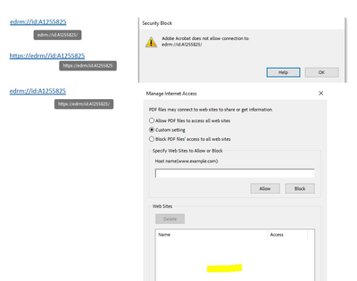

Community Beginner ,
Dec 14, 2023 Dec 14, 2023
Thanks Amal,
I reset the Acrobat preferences using the 'Manual' method from that link, tried again and get the below error:
Security Block
Adobe Acrobat does not allow connection to:
<URL>
I then closed Adobe, ran the 'repair' option and tried again and had the same error.
Dougal
Feb 13, 2024 Feb 13, 2024
Hello, as mentioned I have tried all the above preference options, as well as whitelisting in the appropriate areas within the preferences e.g. 'allow PDF files to access all web sites' and 'custom setting' with whitelisted URLs etc, and there are no blocked websites listed. As mentioned, this is not a website per se but a custom URL (see my screenshot above).
The issue with a custom-type URL remains, and does not occur with other PDF readers.

Mar 15, 2024 Mar 15, 2024
Hello Team,
I was able to reproduce the problem - PFA. I can confirm there are no problem with the URL or custom settings, but still seeing the problem. Based on this I was able to extract some insights, we're not pointing the app or protocol to make this hyperlink to connect to our system.
Could someone tell me what will open when we click edrm://id:A1255825 any app will open or it'll redirect to browser (search engine)
Jul 17, 2024 Jul 17, 2024
Hi Prasath,
"edrm://id:A1255825" was just provided as an example of a 'custom URL'.  In this case, "edrm" is an on-prem server name and "id:A1255825" is code which points to document id 'A1255825'. So, what that specific URL does is to open document id A1255825.
