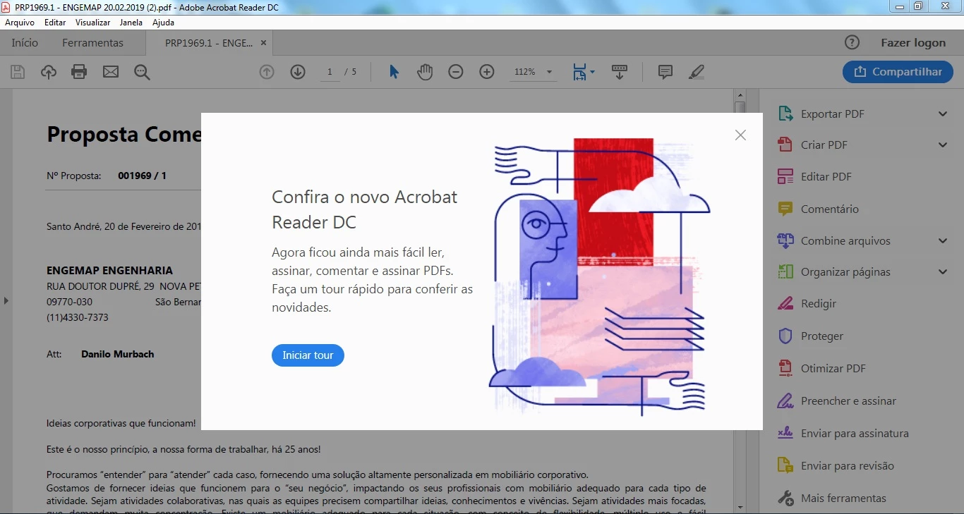

Always when I enter Adobe Acrobat Reader DC, the program starts very slowly...the file freezes until I can use it...then after a while, appers a tutorial page like that:
  I think this tutorial is making Acrobat slower...because after I close it...I can use the file faster...but What Can I do for that tutorial don't apper anymore?
When I am putting a signature in the file...it gets very slowly and it wasn't like that before...to save the file in Acrobat Reader is slow too...What Can I do to make it faster?

Correct answer ravig71162695
Sorry to hear that you had trouble.
Would suggest you to create the following registries -
[HKEY_LOCAL_MACHINE\SOFTWARE\Policies\Adobe\Acrobat Reader\DC\FeatureLockDown]
"bToggleFTE"=dword:00000001
Let me know if this does not solve your issue.
-Ravi Gupta

ravig71162695Correct answer
Adobe Employee
May 15, 2019
-Ravi Gupta
