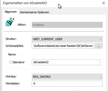

Modify HKEY_CURRENT_USER\Software\Adobe\Acrobat Reader\DC\AVGeneral\bEnableAV2
Set the value to 0. You can set this up in the Registry. Hope this helps 🙂

Setting bEnableAV2 to 0 or deleting sets it to the classic ui.
For the Reader it is under HKEY_CURRENT_USER\Software\Adobe\Acrobat Reader\DC\AVGeneral
