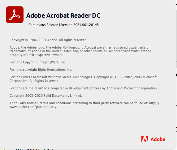

It is Mar 21, 2021, and the problem still persists. I installed Untitled.png
and tried to print a document with no luck.
I tried to choose pages like Patrick and still have the same problem.
