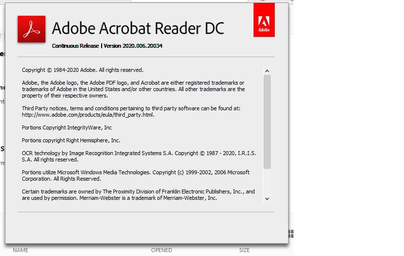

I am not able to open documents created by others for filling and e-signing. I am also not able to start adobe reader as an administrator. My OS is windows 10 version 1903 build 18362.592, 64 bit, and adobe reader version is 2020.006.20034

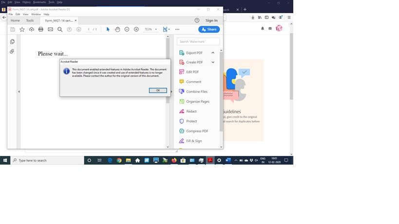

Whenever I open any document, I get the following error:
The document enabled extended features in Adobe Acrobat Reader. The document has been changed since it was created and use of extended features is no longer available. Please contact the author of the original version of this document.
I am attaching the screenshots of the issue faced.windowsversion.jpgadobeversion.jpgerror1.jpgerror2.jpg

I am facing the issue with all the files. I also disabled the enhanced security settings, but still facing the same issue.
I have upoaded one of the forms where I am getting the error, the file contents are displayed, but I am unable to make any change or afix digital sigature.

The above file shared is already digitally signed. So, once the file is already signed, you won't be able to make any changes.
