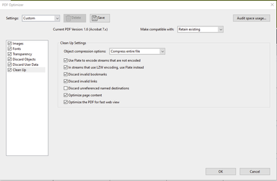

I went back and tried this again and under the pdf optimizer, clean up tab, there is no option to remove hidden layers content and flatten layers.
thanks for the note though.
