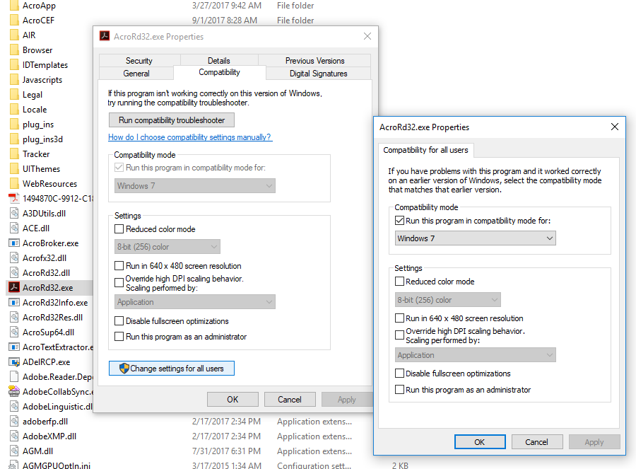

I too was having this problem and getting frustrated with the lack of good advice.  Everyone seems to assume it is the PDF that is bad, or just user error.  After just making do and getting very annoyed for the last few months (if I keep trying to open the PDF eventually it will open) I discovered something from another thread that seems to fix this permanently.  (At least for me in Windows 10)
Change the "compatibility mode" for Adobe Reader to be for Windows 7.  I changed this on the file "AcroRd32.exe" which is found in "C:\Program Files (x86)\Adobe\Acrobat Reader DC\Reader" for me.
Right click on the file, select "Properties", then the "Compatibility" tab.
Now click on "Change settings for all users"
Now you can check the box "Run this program in compatibility mode for:" and select "Windows 7"
Hope this helps someone! (Also hope this helps others not be so quick to jump to conclusions about this problem.)
