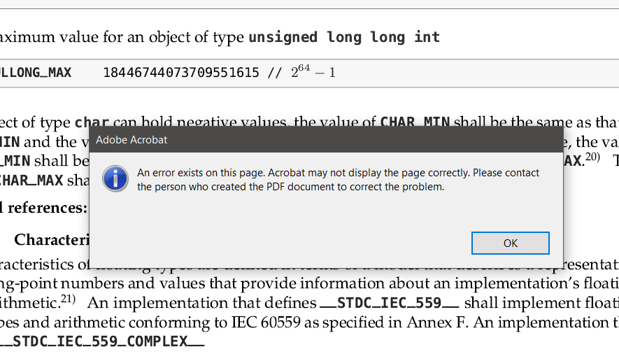

3 pages are shown blank with an error "A number is out of range", good in Android and Chrome
  • March 22, 2020
  • 4 replies
  • 3309 views
There may be some issues (though strange for ISO/IEC doc) but even if there is it should show the page as it is shown in Chrome and Acrobat for android. The problem also occurs in Adobe reader. All latest 20.006.20042. Ah yes, Windows 1909, latest updates. Looks like fonts may be corrupted, I see the same issue on the forum... When I do Ctrl-D, fonts, it stops on 6% of all fonts...
<poster's URL removed by moderator due to illegal posting of copyrighted material> pages 22, 24 and 25.

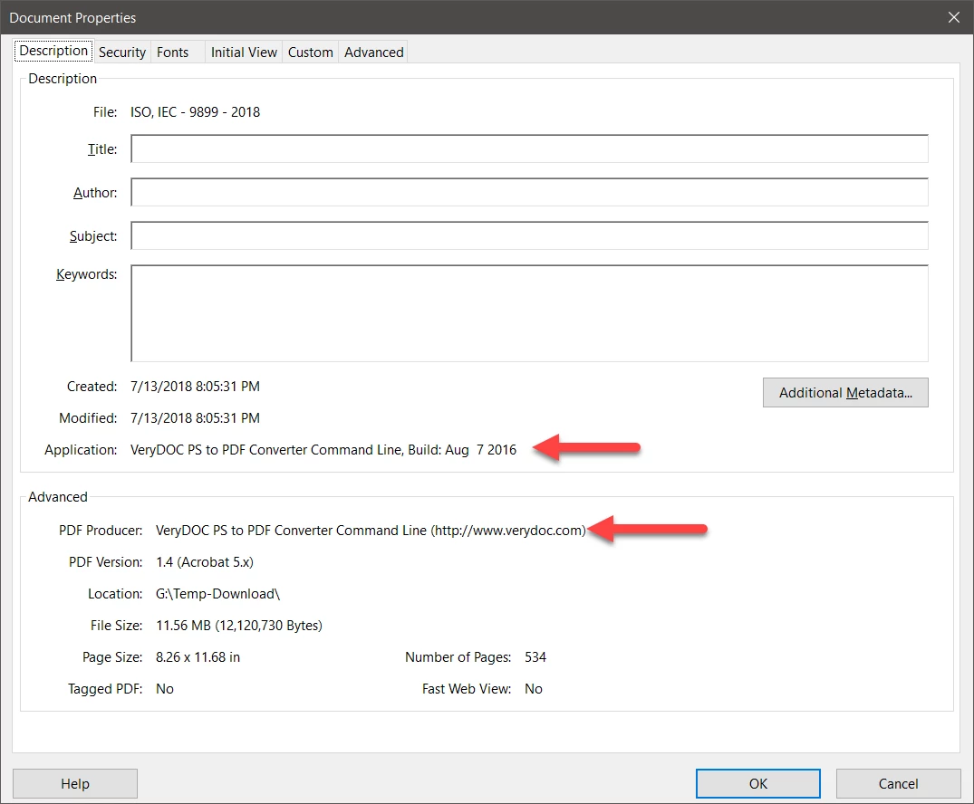

As the chair of an ISO committee, I have real trouble believing that this is a PDF file coming directly from ISO. It actually looks like someone got a protected PDF file and tried to unprotect it by “refrying” it through some funky third party software.
Why do I say this? Look at the Document Properties.
Based on our knowledge of ISO's publishing process, the VeryDOC PS to PDF Converter is not software used by ISO for publication. The output is done via a process that ultimately exports PDF from InDesign and has bookmarks.

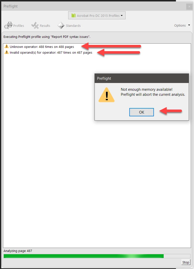

Running the Acrobat Pro Preflight profile Report PDF syntax issues I get the following results:
This is clearly a very bogus PDF file with unknown operators and invalid operands. The problems are so bad that what should otherwise be a relatively simple PDF file, forces Preflight to run out of memory.

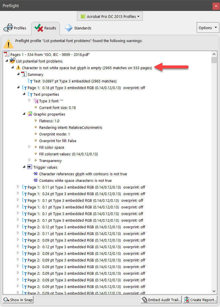

Also, running Preflight's List potential font problems profile yields:
The fonts are Type 3 fonts - something you wouldn't normally find in PDF files from ISO and they certainly wouldn't be at 0.18pt.
Bottom line is that this is a very malformed PDF file that I am positive did not come directly from ISO, but rather via some attempt using some very bogus tools to remove document security via “refry” mechanisms.
Sorry, but this file cannot be fixed!

ZBallingAuthor
April 6, 2020
Here it was created with LATEX. As you can see in C++ ISO/IEC doc, that is open source. https://github.com/cplusplus/draft/tree/master/source
What then was used to add ISO/IEC 1 page I dunno.
"wouldn't be at 0.18pt" Well, it is not normal font, I suppose, but something from LATEX. And it has very strange fonts.
Anyway, the file works normal in Chrome and everywhere else except Adobe app. That is strange. Also that glyph that is empty can be from LATEX, I think a common problem as LATEX uses many such things to alligh text.

The URL you pointed us to doesn't contain this particular PDF file. Furthermore as can be seen from the information on the bottom of the second page of the PDF file you originally pointed me to (a specification for 'C' and not 'C++'), the ISO specification is not "open source" anything at all:
As such, I am editing out the URL you posted initially since it is an illegal posting of an ISO specification. However, assuming no ill intent on your part, I am not reporting this to the ISO copyright office.
In terms of the PDF file itself, we stand by our analysis of this being a malformed PDF file, not due to the sillinesses in terms of the font point sizes (they are perfectly kosher), but rather the unknown operators and invalid operands. Those could be very dangerous
The fact that this file opens in Chrome and possibly some other viewers is irrelevant here. Acrobat does issue diagnostics for very serious problems that other viewers might ignore. Some such problems could conceivably compromise your system's security and/or might be signs of malware. We'd “rather be safe than sorry.”
Speaking of ISO standards, PDF is an ISO standard, ISO 32000-2. This alleged final copy of ISO/IEC 9899:2018 Information technology — Programming languages — C (note, not C++) absolutely does not conform to the current or any other previous ISO standard for PDF. Sorry!
