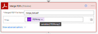

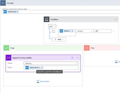

Community Beginner ,
Jun 03, 2025 Jun 03, 2025

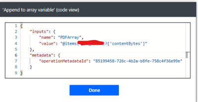

I have a virtually identical flow to yours, including a compose step for debugging, but I'm receiving the same error you encountered. I've verified that I'm using the "array" view in the Merge step, but nothing I do seems to work.
The only thing I can think of is that the code view for my "Append to Array Variable" step also includes some metadata in the JSON automatically, but this isn't something that can be changed as it's auto-generated by Microsoft (see image)
Here's the non-code view:
When I check the ouput of "Append to Array" using a "Compose" step ouside of the loop, it looks just like what you've posted. I've also verified that the JSON code view of the "Merge PDF" step is accurate.
This seems like such a simple task, but I'm driving myself up the wall trying to debug this. Is there anything obvious you can see in my flow that might be causing me to still get the same error you did?

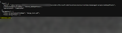

The first thing I notice is that your file content is not a PDF, a pdf's base64 will start with JVBER. At least in all of my work.  If the file is not a PDF then you need to convert it to a PDF first.
The Base64 bytes of the files I'm passing aren't visible in any of these image; they're just code view of the flow steps. I've verified in my tests that I'm using PDFs, and there's a conditional step displayed in one of the images to verify that only pdf attachements are passed to the array.
To clarify, here's the input view for the Adobe Merge step that's failing; I've verified via a "compose" step and by manually reviewing the output of "Append to Array" that both file objects are in fact valid PDFs.
and the second file (for obvious reasons I've truncated the full view of the input)
When I check the output of both the "compose" and "append to array" steps from a failed run, they appear to match the structure in your working example (the below images are truncated for clarity)
I'm wondering if something about the "Append" step is missing the final "==" intended for signaling "end of file" now that I look at it.

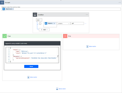

Explorer ,
Right, i did see that. then as I was looking back at nmy own question I saw the wrong base64.  My bad.
I have been having some issues with item()?['contentBytes'] at times. sometime you include the name of the for each and other times you don't. but this is what I have found:
  • Use item() inside the body of a For each loop — this refers to the current item being iterated over in that loop.
  • Use items('For_each_-_Attachments') outside the loop body (e.g., in an If action following the loop, or in an expression not nested in the loop scope) to reference a specific item from the loop by name.
I have been using ChatGPT to help me out and it has been quite useful.
I would try removing the For_each reference in your Append to array variable.
