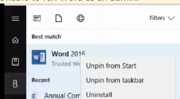

New Microsoft surface book laptop - it came with 1 year of free MS office which has to be installed from the Windows Store.  Since it's a Windows Store app, Office does not appear in Add / Remove Programs.
The shortcut to the Office apps is not a traditional .exe, so I cannot run it as Administrator.
If you're in Word and you click Save as Adobe PDF, an error comes up
If i go into Acrobat, and go to Preferences and Convert to PDF, none of the Office options are there

The Office offline installer is not applicable here as this is a version of Office published through the store as I've mentioned a couple of times.
We ended up uninstalling it and using Office from our Office365 E3 subscription and are not having issues.

Ok, that would explain why the add-in seems at least half loaded. Try running as administrator from its location in Program files.
