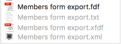

In Acrobat Pro DC, I am trying to import data to populate form fields.
Why does the import form data function only accept FDF files? (all other file types are greyed-out)
My understanding was it should be able to accept both FDL and XML.

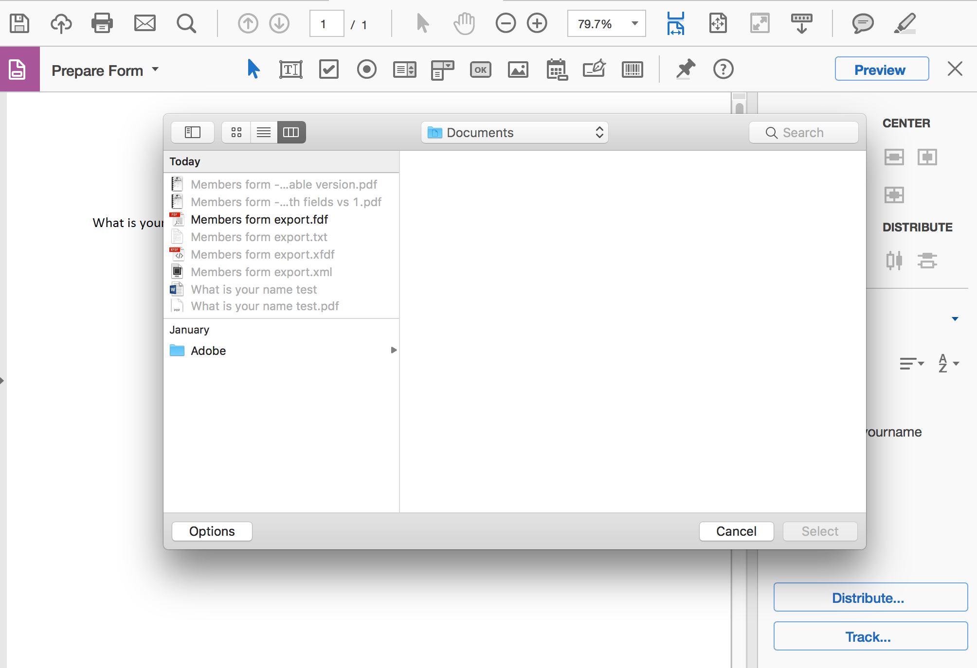

The dialog seen directly after Import Data is:
What do you see under Options?

An AcroForms* PDF form can import data as FDF, XFDF, HTML and XML.
* vs an XFA PDF form, made with LiveCycleDesigner, see: https://www.foxitsoftware.com/blog/?p=2867

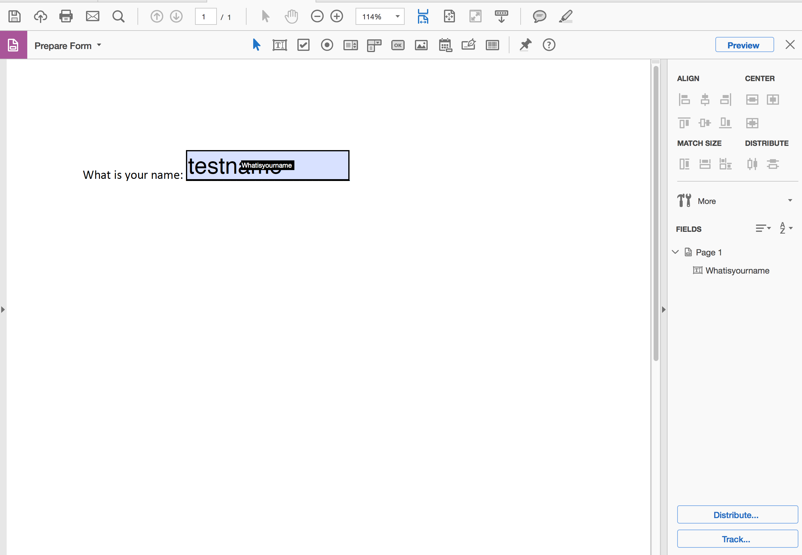

Import Process:  Tools / Prepare Form  / More  /  Import Data
try67
Sep 24, 2018 12:27 PM UTC
OK. Can you post a screenshot of what you see after doing that? Use the Insert Image tool when replying via the forum itself, not via an email.
