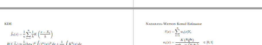

I use Acrobat DC 17 on Windows 10 with two pages scrolling view and options "Show gaps between pages", "Zoom to fit page". I think there are two problems with this option.
1. When I push "Page Down" button screen flips through two pages but the subtle horizontal line appears at the top of the screen with width which is exactly equal width of the gap. This line is either gray or contains small piece of the previous two pages. If you push "Page Down" many times one by one this line will grow with every keystroke therefore big vertical offset appears. The same thing happens when I use a single page view. See top of the screenshot below to watch this vertical offset (i.e part of the previous two pages above grey horizontal line):
2. Also when I press "Right arrow" button there is no offset but every such keystroke flips only ONE page. So I have to press "Right arrow" twice to see next two pages and this is very annoying.
But if I disable "Show gaps between pages" then everything will be OK. I.e. offset will not appear after "Page Down" button and "Right arrow" button will flip through two pages instead of one.

Hmm... These two issues appear only for "Two page scrolling" view. For simple "Two page view" case everything is OK.
Also I have just discovered that the first issue (vertical offset when pressing "Page Up" or "Page Down" buttons; "Show gaps between pages" and "Two pages scrolling" enabled) appears only when there is some space on the left and right sides of the screen (this is a usual thing when pages are narrow but long). In that case there is a vertical gray (background) line on both sides, See my video below (in this video I pressed "Page Down" button multiple times):
That happens with all my pdf documents. Could you try to reproduce this?
