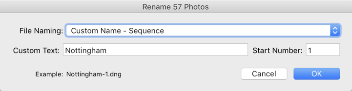

You'll note that I do not have much of any custom names (for the slides) at this point. I've tried various approaches to changing the name of the slides as I processed the images but l gave up as it was  tortuous—too much stopping and starting. If you really wish to provide custom names to the images after they've been photographed, there is a MUCH easier way: when looking in the images in Library mode select all of the images that will share a name. Then from the Library menu select Rename Photos... Select option "Custom Name - Sequence" from the dropdown menu, provide the custom name, verify the Start Number, and tap OK and you're done. However, I honestly never found a strong advantage of customizing the names and often left the images with whatever name they received. Simply, Keywording is much more powerful and efficient than  naming  the images.
As stated, the goal is to process the images as efficiently as one can. If there are individual images you wish to enhance, you can always spend time with them in Lightroom one at a time. However, any time you can alter and fix more than one image at a time, the better. Lightroom helps this considerably by providing many ways to alter many images at a time.

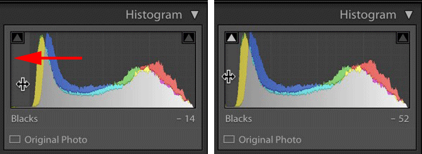

Another critical option that's not available is any grain correction—Photoshop and Lightroom do not know how to get rid of photographic film grain, that's a film issue, not a digital issue. If you have an image with noticeable photographic grain and you wish to fix that, your best option is to use a high-end scanning software such as SilverFast by LaserSoft Imaging. I've a sample of the benefits of this feature in the beginning of Part 1.
If you've taken your images as raw images, you will have excellent success with the Highlight and Shadow sliders. Likewise, you can control the white and black regions on the histogram with either the White and Black Sliders or by going up to the histogram, mousing down in one of the five regions (as you mouse-over each region will slightly lighten up) and dragging left or right as shown below.
Fortunately, one of the tools that IS available to enhancing the slides is the "Dehaze" tool. Unfortunately this also is a fairly new tool and is not available in earlier versions of Lightroom.

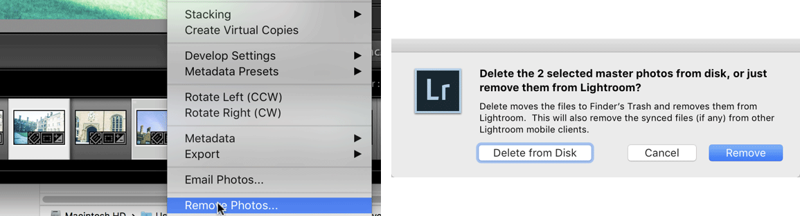

You can either delete the images as you look though your images or you can mark your image so that you can "Find" the images with that marking (see next paragraph) and delete all at once. Whichever one appeals to you is fine.
In addition to deleting the images as you find them, you can be a bit more methodical and identify which images are either particularly good and/or particularly bad. This can be done by selecting an image and tapping the "P" or "X" key as you go through your images. If you look at the images below, in the upper left-hand corner you can see the white flag ("flagged") or black flag (rejected) icon identifying your choice.
Besides using the Flag and Reject, you can also use Ratings (*) and Labels (colors) to do the same thing, Flag and Rejecting are just two more ways to identify images.
The one advantage to flagging the good and bad images this way is that you've already identified which images deserve special attention. This might save you time later on.
To delete an image, select one image, several continuous images, or discontinuous images. Then, either tap the "Delete" key, go to the Photo menu and select "Remove Photo," or right click (as shown below on the left) and select "Remove Photo(s)" (if you select have two or more photos, this becomes plural). If you do any of these things, a new window pops up (shown below on the right) verifying if you want the images Removed from the catalog (but will still remain on your computer), or "Delete from Disk" which places the images in your computer's Trash Can where, if weak in heart, you can retrieve them again so long as you've not emptied your computer's trash can.

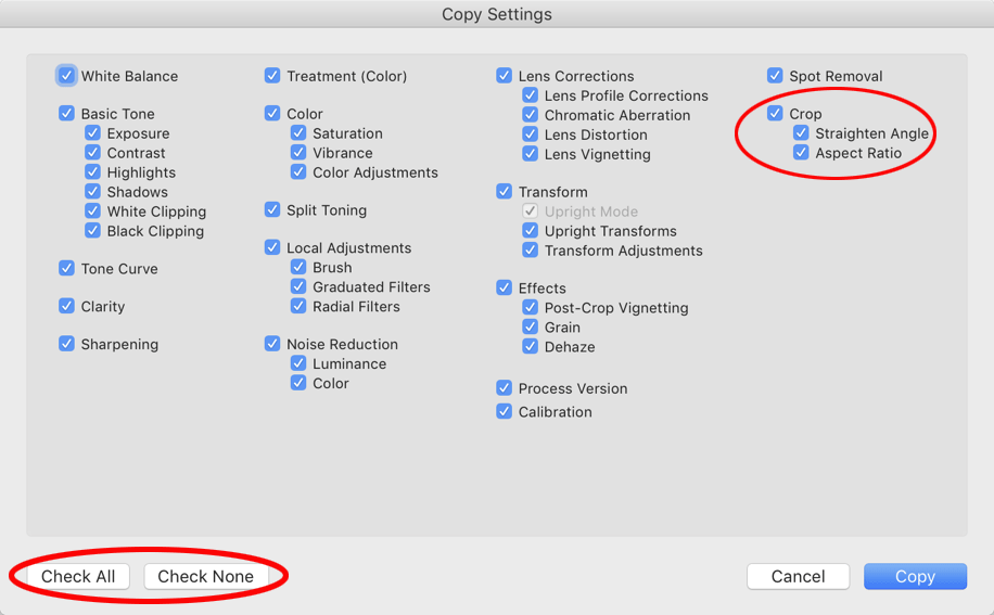

Copy & Paste is similar to Previous but is best when you want to Paste "almost" every attribute you corrected. To use this set of tools, it  requires an extra step before the Paste button.
You'll notice that the Copy button has an ellipse and that means that this will bring up a dialog box.
When this window comes up you can accept all of the boxes being checked or un-checked (lower left in the image above). As needed, you can check or recheck the options you  want maintained. Notice, for example, that you can turn off  rotational dynamics so they do not affect subsequent images.
To use this, you first select an image and make all of the adjustments you wish to make, then press Copy… Be sure that all of the attributes you wish to paste are selected. Then select an image and press  the Paste button. All of the settings you copied will be pasted onto the new  image. The advantage here is let's say that you had selected an image and made a bunch of corrections, including rotation. Assuming that you have other images that have the same problems but do not need rotation, by using Paste instead of Previous, you can pass on all of the adjustments but not rotation.
Once you've copied the alterations you've made, you can then select new image and then press Copy and repeat until you've adjusted all of the images with similar issues. What you cannot do with Paste is to select a number of images and then tap the Paste button—it doesn't work. That's when you need to use the "Sync…" feature described next.

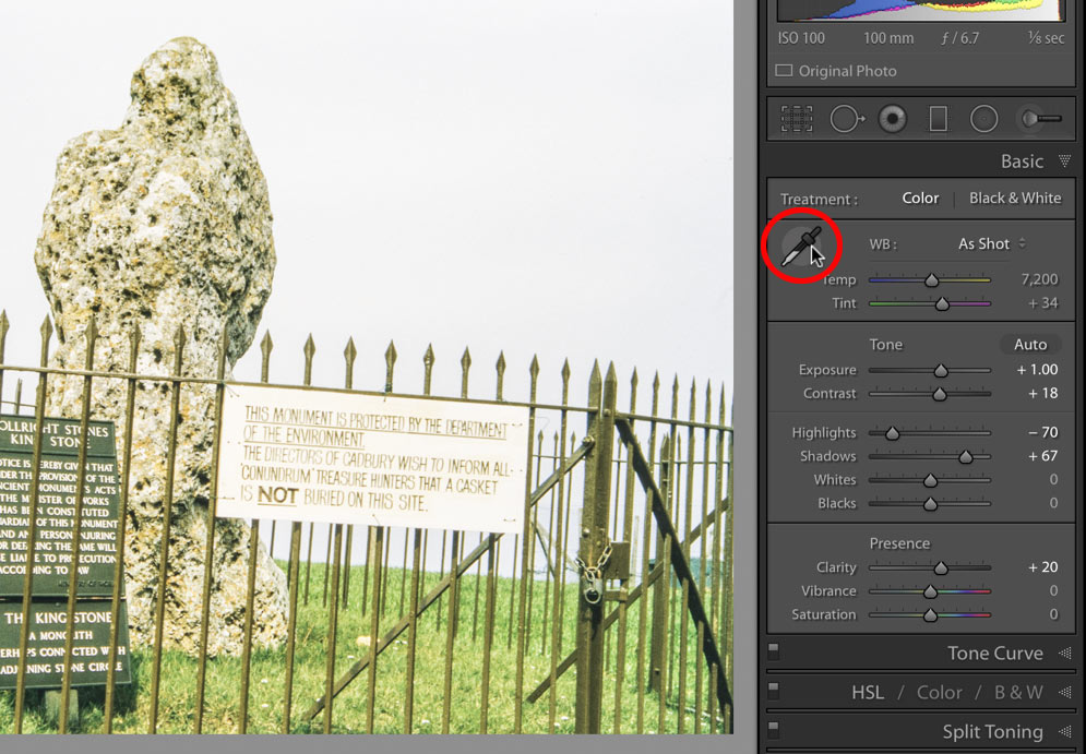

Probably the most common issue/problem is white balance caused by fading of one or more of the emulsion colors. Fortunately, using Lightroom's White Balance eyedropper (and if something in the image is probably gray), you can sneak fairly close to what the correct temperature and tint should be.
At the top of the Basic panel, next to the Temperature and Tint controls for White Balance, is an eyedropper. You can either tap on that with your mouse or press the "w" key (for "White Balance").
Now, click on something in the image that you think is probably gray. As you can see on the left image below, I've chosen the sign. I have no idea if this is true gray but it's probably good enough to get close to what a balanced White Balance should be. On the right in the image below is the instant result of clicking that eye dropper on the sign.
[Note: how does the White Balance Tool work? As you probably know, gray is an equal mix of red, blue, and green but the trick is that there must be the exact same amount of red, blue, and green. When you click on something that is (or might be) gray, Lightroom will adjust the colors in the image so that if they were not the same before, they are now. (A mid-gray is a better choice than light or dark gray.) In the image above I had nothing else better to click on so I opted to use the sign.
Occasionally there's not enough information in "white" for Lightroom to make a correction as shown in the image below. Here, the white of the jonquils was too light  and I could not get sufficient information for Lightroom to work with and could not use this technique to white balance the image. (Note: if you make the image temporarily darker, this approach will still will not work.) Your only recourse here is to "eyeball" it. While challenging to do when you first start trying to white balance by eye,  the good news is that the more you do the faster it gets.]
To finish up this image I noticed a tad of blue in the upper left corner meaning that even if this was Great Britain, it wasn't a completely overcast day. So I dropped the Exposure a tad, bumped up the Contrast a tad, dropped the Highlights as much as I could and pushed the Clarity up a bit. Below is the "before" these adjustments and below that is the "after" these adjustments.
[Let me repeat, if this was a JPEG, the final results would not have been as good. A raw image contains significantly more information than a JPEG.]

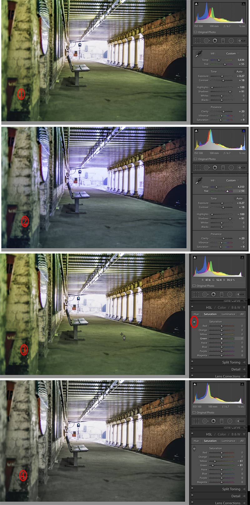

There will be times when the emulsions have faded to such a degree that doing a simple White Balance as above will not work. If this is so you'll probably have to manually tease the Temperature and Tint controls or in extreme condition, open the Hue, Saturation, and Luminance Panel and see if you can control the problem from here.
Below is a great example where regular white balance completely failed but making adjustments in Saturation solved the problem. In Image #1, you can see the problem. I'm in a train station and the cement floor and walls appear moss-green. They probably are not this color. So in Image #2, I try to white balance the image off of the wall and this was a failure; you can see how in the distance everything is now bluish purple. The problem is probably the light source from the ceiling is giving the area a color-cast.
So in Image #3 I go to the Hue, Saturation, and Luminance Panel and select Saturation. If you look in the right hand panel, you can see that I've circled the Targeted Adjustment Tool. If you click on that and go to a region that has color in the image, you can click and drag up and down on the image and that will increase (up) or decrease (down) the saturation. Using this approach you can see that it did a good job in removing the errant green from the cement. Obviously this will not work all the time but since cement shouldn't be green in most circumstances, here it worked fine.
If the colors are really really bad due to the degradation of the film, I'll strongly consider converting the image into a Black & White image. If that fails, it's a true tosser.
However, just keep in mind that anything you do to help the image is better than the image sitting in a box continually getting worse and worse. If the image is the only known image of Aunt Maude, you do what you can and be happy that you caught the image before it was completely totally gone.

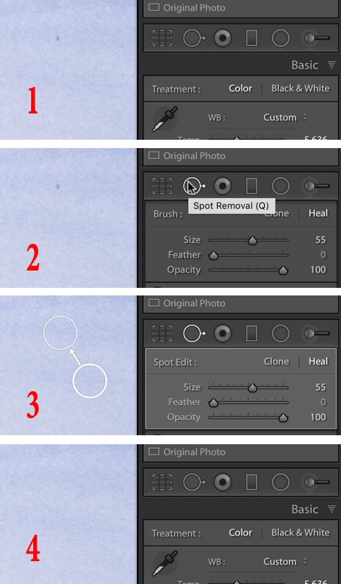

Despite dusting every slide prior to taking its photo, there will be an occasional bit of dust on the slides that will show up in the photograph. Fortunately the dust is as easy to remove in Lightroom as is sensor dust  from a digital image. In image #1 below you can see the small spec of dust. [Note: The big difference between dust on a slide as opposed to dust on your sensor is that the dust on your slide will probably be sharper then sensor dust which will be fuzzy and out of focus.]
To remove the dust from the image, select the "Spot Removal" tool shown in #2 (or press the "q" key) (you can vary the size of the tool's active circle by pressing the "[" or "]" keys to encompass just the speck), and click. You will see two circles with  one having an arrow pointing to the original circle. This indicates where the new fill for the spot you clicked on will come from as shown in #3. [Note: if you think there's another region in the photo that would provide a better replacement to Lightroom's initial selection, just drag this second circle to that spot. For example, if the dust is on the edge of a cloud and Lightroom selected the middle of a cloud, move the second circle to the edge of a cloud somewhere else.] Image #4 shows the results of this spot removal. If you have a hair or a long thin item you wish to remove, rather than "click" with the Spot Removal tool, simply click and drag over the errant item. Otherwise the process is just the same.]

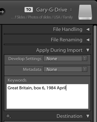

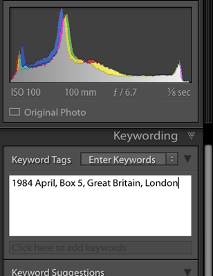

When I photograph a new set of slides into Lightroom, the Keywords I always automatically enter include: the box # (the metal or cardboard box containing the slides (you do number or mark them, don't you?)), the country, and the date (slides always have the date of processing pressed into the  slide's cardboard). This date will invariably NOT be the day you took the images but it's  close enough if you do not know the date otherwise. If all of the group of slides are from one state or one city, I'll enter that in at this time as well.
The very first image in this article shows where and how to automatically place keywords if you are tethering your camera to your computer. If you did not tether and will be importing the images from the camera's card. you can alternatively automatically enter the default keywords by setting up to import the images and before you tap the Import button, from the right hand side select the "Apply During Import" Panel. From there you can also set automatic Settings, Metadata, and Keywords.
At this point you need to refer back to any notes you have from your storage box or whatever else you have and go through your slides in groups to narrow down the slides to your keywords.
As you enter Keywords, you may have a group of photos that will all receive the same Keyword. You could enter the Keywords as a one-at-a-time process but that's a big time waster. Rather, you want to  select a block of images and set any keywords at once whenever possible.
If you are at the first image of a set, you then need to find the last image of that set to make the group of them all selected. But, while searching for the last image of the set you've very likely will have misplaced that first one.

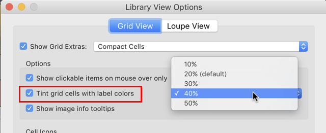

One way out of this problem is to mark the first image to make it easy to find. The way that I like to do this is to place a color label on the first image. After selecting that image, if you go up to the Photo menu, and select "Set Color Label," then select a color. You can also tap any of the 6 to 9 keys and get a color. Alternatively you can right-click on the image and find "Set Color Label" and set the color.
Note that the color is neither profound nor in your face. As shown below, if the image is selected, there is a thin (color) border around the image and if the image is not selected there is a (color) tint to the region around the image. Not significant, but it is something to look for as you look for that first or last image to select.
If you want to set the color so it's easier to see, you can change this by going into the View menu and select "View Options…" toward the bottom of the menu (or select Command/Control-j). Then select the Grid View (the results will show up in either view). As you can see, go to "Tint grid cells with label colors" The default is 20%, I've found that for my purposes here I like 40% or 50%. This makes it much easier to see the first in a set of images I wish to mark with specific keywords.
So, you've colored the first image, gave it a color label, found the last image, select it and backtrack to find that first image. Now you can Shift-click on the first image and they are all now selected.

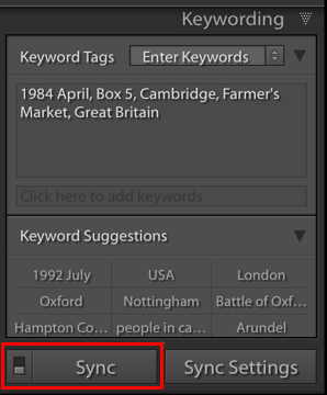

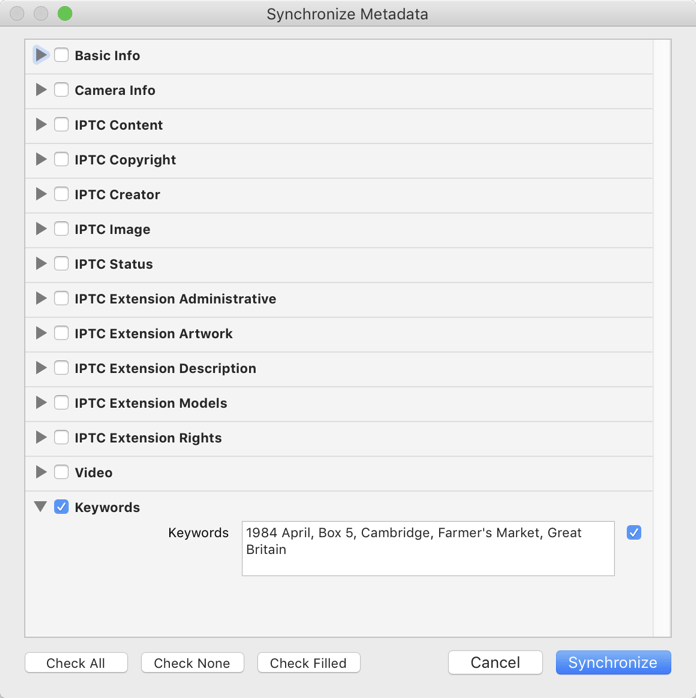

Syncing keywords is a great way to tag a number of images at the same time. The screenshot below shows the right side of Lightroom's window in Library mode and shows the Keywording Panel. You can enter multiple Keywords (place a comma between each keyword). Once you have all of your words entered as you want, and you are ready to import, press the import button.
Be aware that Lightroom tries to speed things up by doing a variety of automatic entries. For example, if you just entered the keyword piano, on the next image, when you click your cursor into this field, it will have "piano" ready to go. In addition, if you type "p," Lightroom will show that word and any other previously created keywords. So, it could display a list showing "painter," "piano,"Piccadilly." If the next letter you type is "i" than it will just show "piano" and "Piccadilly." As you continue to type, fewer options will present themselves and if the word is a new keyword, Lightroom will stop guessing waiting foryou to finish. That new word will now be a new word in the Keyword list.
Also note that  there is a field just below the one shown highlighted above where you can also enter keywords. (It is hard to see that it exists because the contrast for Lightroom's fields are not very good.) The advantage of this one is if you tap the Enter key after each submission, Lightroom automatically enters a comma, ready for the next word. You can also enter multiple keywords in this field as long as you place a comma between each keyword.
Assuming you have multiple images selected, after you've entered in the Keyword(s) you want, notice that there are now two buttons on the bottom available to click on on the bottom as shown below.
On the right is one called "Sync Settings" which does the same thing as when you are in Develop mode (and let's you sync the image enhancements from the primary selected image). The "Sync" on the left which provides a whole new window shown below. The very last row in this window is for keywords. This should display all of the keywords that were entered for the primary selected image. If you want, you can enter more keywords here. The good thing here is that if there are images with unique keywords (e.g., someone's name), when you Sync the unique Keyword will not be removed. Lightroom respects these unique Keywords and leaves them alone.
At this point, be sure the check box on the left is checked, and then press "Synchronize" and those keywords are now entered for all the selected images.
By the way, if you have a group of images selected and any of them have an asterisk "*" following the keyword, that means that one or more (but not all) of the images selected have that Keyword. As shown below, not all of the selected images have the "Farmer's Market" keyword, but all of the selected images have 1984 April, Box 5, and Great Britain as keywords.

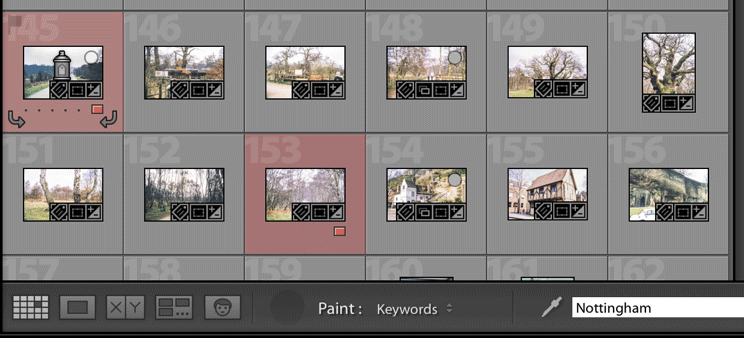

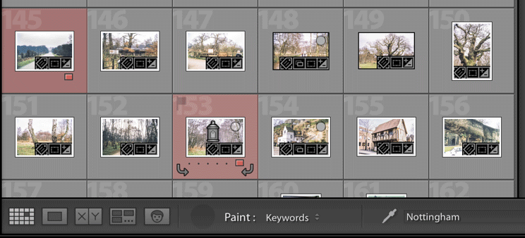

Let me show you one last way to set keywords: the Painter (aka the Spray Can). To use this you must be in the Grid view in the Library mode.
Using Painter is kind of a mash-up of "Previous,"  "Copy & Paste," and Sync" for enhancing the images but cooler.

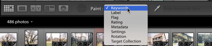

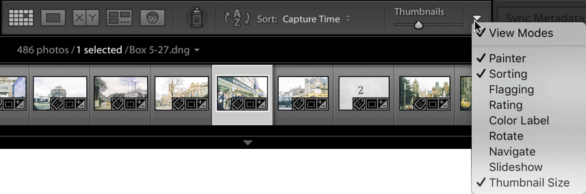

Using Painter is a four-part process. Below I've found a set of images (between and including the images with the red label) that were taken in Sherwood Forest and I want to add "Nottingham" to their keywords.
Notice in Tool region there's an image of a spray paint can. If you click on this you can see the word "Paint" and a dropdown menu. From here you can see the range of stuff you can "paint" with the Painter tool. Select Keywords.
Next type in the word you wish to paint, I added "Nottingham." If you want to add more than one keyword, simply place a comma after each word (e.g., "England, Nottingham, Sherwood Forest")
Now bring your cursor (shaped like the spray paint can and seen in the top-left image) up to one of the images you wish to add "Nottingham" to the Keyword list. It's important to place your cursor ON the image, not  off the image.
From here you can either simply click and/or drag on/across the images you wish to add the keyword to. This will not affect any keywords that are already assigned to the images, it only adds to the images. Also, notice the image below showing a white line around all of the images where the Painter successfully sprayed. If you inadvertently clicked or dragged over an image that should not have this keyword, simply press the Option key and re-click on that image and that (those) image(s) keywords will be removed.

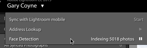

Face Detection
Especially if you have  photos of friends or family, turn on Face Detection. this is done by going up to your name in the upper left corner, clicking, and dropping down to the bottom of that menu as shown below.
Please note that this will index (and look for) faces in your entire catalog, not just any specific folder. And, if you've created a large number of photos before starting this, it will take some time for all of the images to be indexed.
Face Detection is very good for identifying full face or mostly full face images in your photos. Profiles and back of heads are not good for automatic face detection (but that doesn't prevent you from identifying who these heads are).
If you want Lightroom to point out potential faces and if you've already selected Face Detection (above), in the tool region above the thumbnails you can see a face, click on this. and Lightroom will point out what Lightroom considers a face. This is shown in the image below where Lightroom says "Draw Face Region." I should point out that in the beginning Lightroom can be howelingly wrong in determining what's a face or even the sex of people, but as you teach it faces Lightroom not only gets better at determining what in an image is a face but also becomes very good at recognizing who's who.
Also note the face image to the right of Survey View (circled in green) below, this gives you "People" (or tap "o"). If you click on that, you will get a grid of all of the faces that Lightroom thinks it sees. From there you can easily run though these images and identify who's who. AS you progress though this, Lightroom will get better and better. And for the images that are clearly not faces or people you do not care to know, simply tap the Delete key and not have to deal with them again.
The difference between having a region drawn around faces (with Draw Face Region) is that you can see the whole image and can therefore see the images in context. If you select to view the People option, all you see are faces in a grid fashion and will not have the rest of the image to put the face in context.
