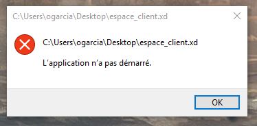

My probleme is XD installs but fails to launch,
Sometimes a blank pop up appears but 1 sec and disapear.
Sometimes the program did't open at all.
I can't install an other version of my graphic driver, it's a professional pc. But my colleague has exactly the same version of mine with the same version of windows and it's works for him ....
I have one error msg when i want to open a XD file :
whith just "pathfile/namefile" and "The application did not start".

Adobe Employee ,
Jan 18, 2018 Jan 18, 2018
If you're not seeing any of the log files I listed above, please use the Adobe Log Collector link and send along the ZIP file that tool generates.  Thanks for helping us figure out what's going wrong!

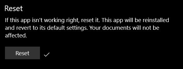

I have a solution and it works for me ! First , you search your Adobe XD on Windows 10 Search Bar here , Right Click on the Adobe XD to go to "App Settings" :
Then you go to to Reset section and Click Reset Button like below . Start the app again , and it works !
