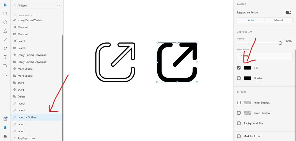

Hi.
For both below paths the border size is 0.5 but as you see the first one is some kine of dobule line poth.My desire size is 1.7 but with this doubled line it does not come below 2.
How can I change it to look like the right one(just a single line path)?
Thanks.

You need to Outline strokes and then delete one of them
Learn how to apply outline strokes to paths and shapes | Adobe XD

Thanks for your reply. Unfortunately Outline strokes does't do anything helpful.

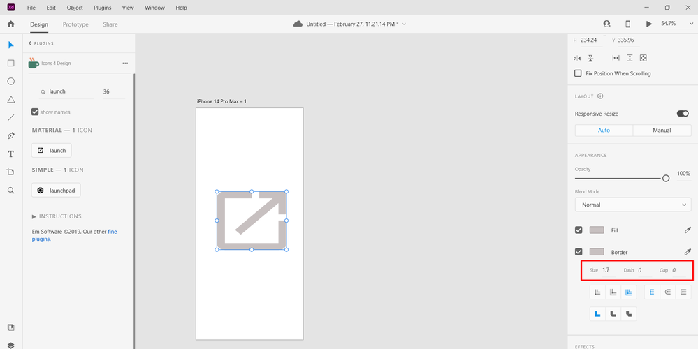

Hi @Bill28501756kh5j,
Thank you for sharing the screenshot. Would you mind confirming if you've created this Icon or used any plugin to get this Launch Icon? Is it possible for you to share the XD file with me over a private message so that I can check on my end?
If yes, please upload the file to a shared location such as CC or Dropbox and share the URL with me.
Please also try the steps suggested below-
  • Select the object with the border you want to adjust.
  • In the right panel, click on the "Border" option to expand the menu.
  • Under "Border," select the "Solid" option instead of "Dashed."
  • Adjust the border thickness to your desired size of 1.7.
  • If you still see a double line path, try adjusting the "Gap" value to 0, which should remove any space between the dashes in the border and create a single line path.
Sharing the screenshot:
Let us know if that helps. We'll make every effort to assist.
