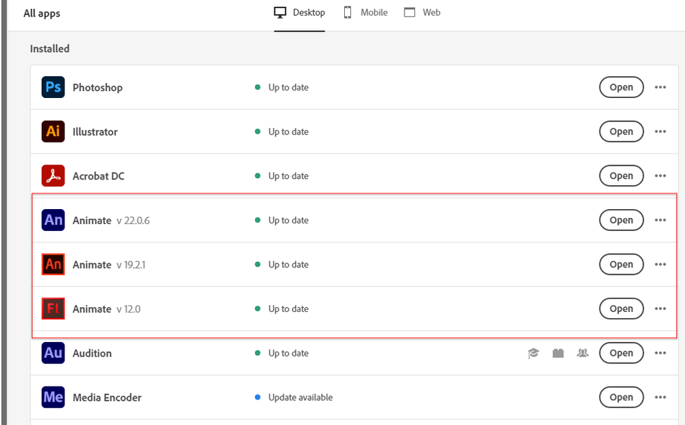

i have win 10 and both animate 2019 and 2022 (as well cs6) all working:
so yes, there must be something specific to your system causing the problem.  what that problem is, i do not know.
the only thing is i can say, at this point, about my situation that might be different from your's is that i installed cs6 first, then 2019 and then 2022.  you may have installed 2022 first and then tried to install 2019.
i don't know that would be a problem, but it might be a difference.
