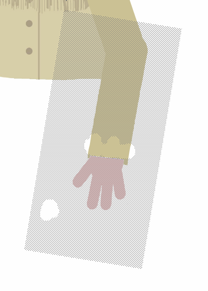

I was able to remove Motion Tween spans, Clear Frames, Remove Layer Parenting without crashing. I'm also going through and converting your imported bitmaps to vector. The imported bitmaps are very messy. Here's just one hand that has some weird alpha regions. Ultimately you want each bitmap to have a bounding box close/tight around the artwork to avoid unnecessary bloated file sizes and overlapping alpha regions. It's just a better and cleaner way to work. As vectors, this issue is eliminated completely...
