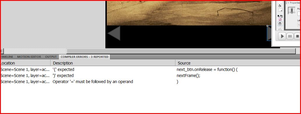

It seems like a great tutorial.  However, as I am following it, I can't make my slide show work as the tutorial demonstrates.  Specificall, after creating the buttons as shown, my slide show will not stop at the next frame, but rapidly runs through all the slides.
I have worked with the tutorial for several days and can not get it to work for me. I get the below error messages when I follow the turorial.

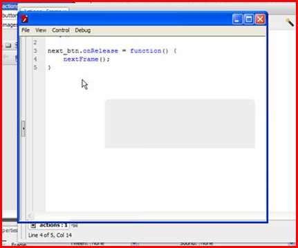

The first image you show is probably the most telling, especially if the second image you show is taken from the tutorial and is not a screenshot of what you've done.  Based on the error messages, you are using parentheses where you should be using curly braces.
next_btn.onRelease = function(){
     nextFrame();
Also, just for the sake of it, check your Flash Publish Settings and make sure you have AS2 selected for the Actionscript version.

Hey Ned, thank you SO very much.  The second image is indeed from the tutorial, and I was using parentheses instead of curly braces.
I was not aware of the different terminology - duhhhhh!!!
So, I am sure that is it!
Again, many thanks for taking the time to help!
