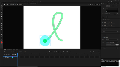

I want to be able to drag the green dot that follows the guide line and its movie clip
Screen Shot 2020-05-08 at 1.26.32 PM.pnghttps://we.tl/t-Eq5IxCIExs

Hi.
Here is a basic solution.
Javascript:
var _this = this;
var ok = _this.BTN_OK;
createjs.Touch.enable(stage);
stage.enableMouseOver();
_this.loop = false;
ok.hit.on("mousedown", function(e)
	_this.canMove = true;
ok.on("pressmove", function(e)
	if (_this.canMove)
		_this.play();
ok.hit.on("mouseout", function(e)
	_this.canMove = false;
	_this.stop();
stage.on("stagemouseup", function(e)
	_this.stop();
_this.stop();
Please notice that I added a bigger and invisible hit area (a Button instance with a circle shape in the hit frame) inside of the ok instance so the user will be less frustrated when the cursor accidentally leaves the drag area and the animation stops.
Anyway, although the code seems to solve this particular case it won't still have a real drag feeling. To achive an ideal feeling it would be necessary to come up with a more complex solution in which you would have to take into account the actual angles between the dot and the path.
I hope this helps and please let us know if you have further questions.

New Here ,
May 11, 2020 May 11, 2020
TKS so much, it works very well, just a little detail the touch devices do not recognize the mouseout, after you touch the button and if you keep the touch it does not matter where the continuous playback is placed until the end, which would be the equivalent of mouseout for touch
