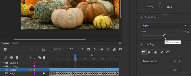

Just for the sake of testing I restored all the fills of the shadow layers to 100% alpha and converted these layers to symbol using the convert layer to symbol option:
Then I just lowered the Alpha value of the resulting nested symbol
Community Expert , Sep 14, 2021 Sep 14, 2021
Ah it's because you're converting it into a Movie Clip symbol; forgot to say it has to be a Graphic symbol.

Thanks, I just checked the file but I couldn't see a problem on my end. I noticed that you lowered the fill alpha of every frame in the shadow layer to 50%
while not the fastest method just exporting it as is gave me an accurate SWF, I didn't have to change a thing.
Then I just lowered the Alpha value of the resulting nested symbol and it gave me the same effect, the SWF was accurate as well.
Here's the modified file along with the SWF: https://we.tl/t-8dmXu1CiGF
Take a look and let me know if you're still having issues.
