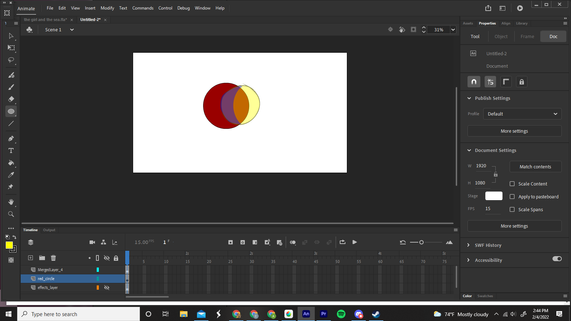

Sadly it doesn't work. This is what happens when I do that which is not what I want. Thank you for your help though.

Basically I want it to look like this on the same layer so I can tween them to move together. I know parenting is a thing you can do in animate, however I need to be able to attach certain layers to other layers and that just won't work if they already have attachments to something else. But when I try to merge it it looks like this. (The effect is applied to the whole of the layer)
I want it to look like this when merged.
I hope this is good enough explanation!!
