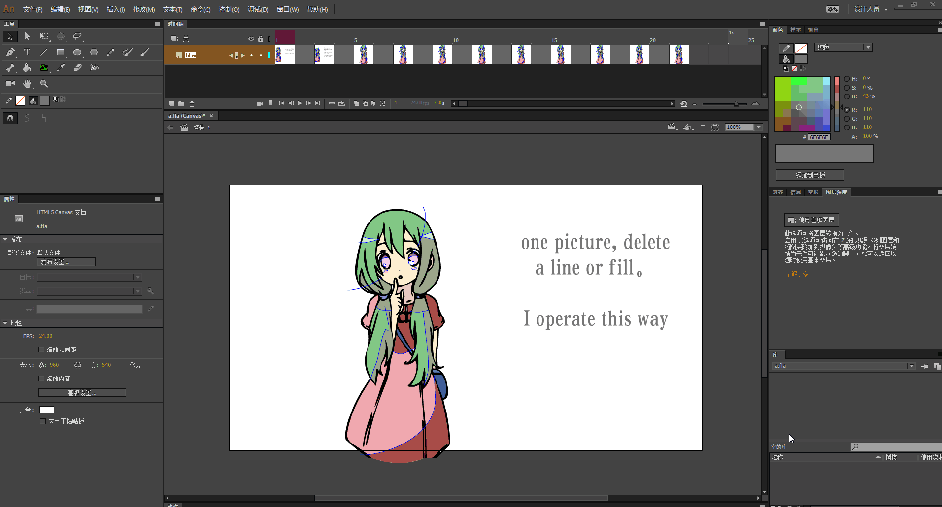

Stroke ,I'm doing this now.
Edit multiple frames--select all--stroke choose none.
Now is the deletion of the fill。This is a problem.

Hi.
Do you need to delete one specific shape color and one specific stroke color in each frame?
Enthusiast ,
Apr 25, 2018 Apr 25, 2018
yes.
Like red, yellow and blue on the screen.
I only remove the yellow.
Each framework does this
