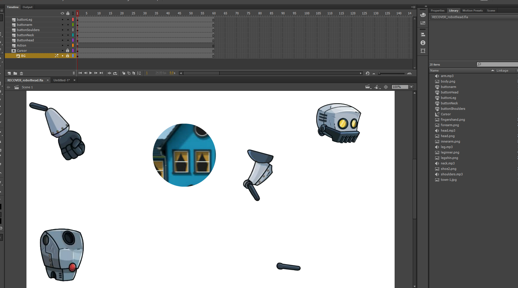

Hello everyone.  I created a project with masking buttons and sound.  The object is to find the body parts, click on it once found and the learner can hear hear the sound.  Everything works fine except I can't seem to get the body parts, which are buttons, hidden under the mask. Thank you for your time.

In your timeline screenshot your buttons are clearly not underneath the mask layer. How were you expecting that they'd be masked?

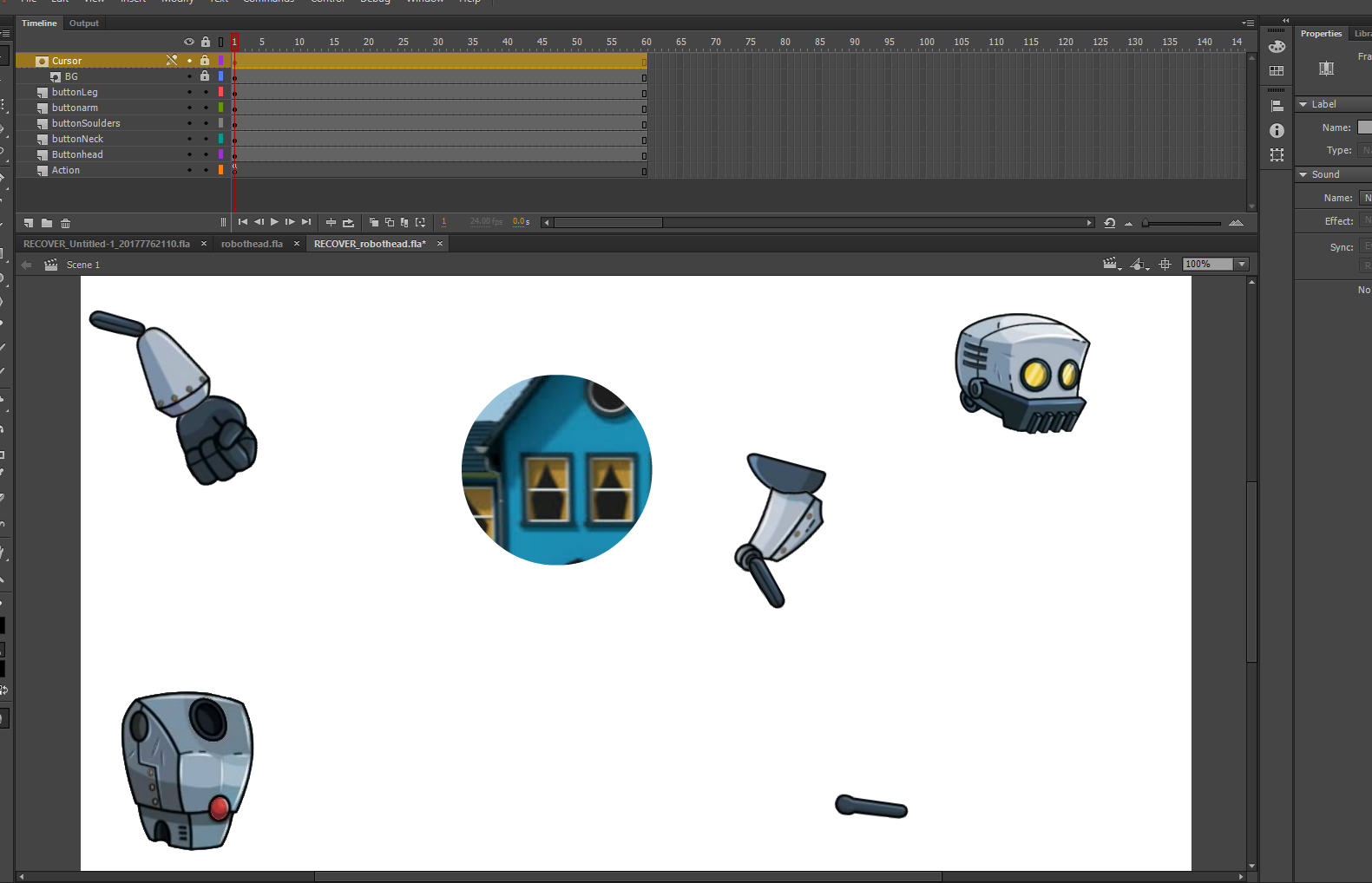

Is this a better placement? This was the original build. I've tried this as well with the same result.  And tried moving the parts to the back.  Not sure what I'm doing wrong..  I tried the background to body parts buttons, sound then mask.  The background to ask then body parts buttons with sound.  Moving the configuration around and so on.  The end result is always the same, .body parts on top of the mask.  Perhaps I'm not smart.  I know it's probably something simple but I've worked on it, researched it for weeks.

Contributor ,
Jul 08, 2017 Jul 08, 2017
You will need to nest the body part layers to the mask layer, like the layer "BG" currently is.
