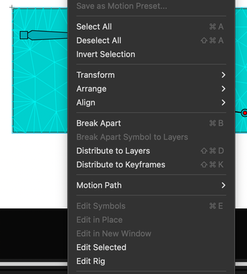

I'm trying to animate something that is meant to be bendy but starts with a perfectly straight sprite. For consistency and my own sanity, I'd like the bones I want to set up with Asset Warp to form a perfectly straight line, down the middle of the sprite. Is there a hotkey or shortcut I can use to force the bones to be on a cardinal direction? In Photoshop, several tools (such as gradient) let you hold Shift to force the tool to operate on a cardinal direction (perfectly vertical or horizontal). Is there a way to do this with Asset Warp? Alternatively, once I've placed my pins/bones, is it possible to change where on the sprite a certain pin is? I don't mean manually dragging the pins around (as this would Warp the Asset, obviously), but actually changing the pin positions relative to the sprite so I could straighten out the bones?

There is a. way to edit the rig after creation without affecting the artwork. Once you create a warped asset rig, right-click on the object to reveal the contaxt menu and choose 'edit rig'. This will bring you into rig edit mode where you can make all sorts of adjustments without any deformation of the underlying art.

This is exactly what I was hoping for, thanks so much!
