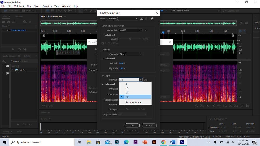

Try doing this
When exporting the file there will be an option "sample type" in it there will be options selected by default as "same as source" change that Screenshot (398).pngScreenshot (397).pngScreenshot (396)_LI.jpg
Dec 08, 2020 Dec 08, 2020
The above reply is completely irrelevant - this cannot possibly have any bearing on a failure to export effects correctly.

Actually it does seem to fix this kind of problem.  I just exported an interview in MP3 format.  It's real strange as opening it up and playing it back in audition it sounds fine - but then opening the same file on any other player (podcast uploader, windows media player, etc) and it's distorted and a mess (mine sounded like the guy being interviewed was in a bathroom!!).  I changed the settings from same as source to 44.1khz 16-bit (Adaptive Noise Shaping) preset and it exported fine.
It seems that when a file is opened up in Audition that it still has access to the original files it plays the original files rather than playing the actual saved edited file - not too sure how it's doing that or where it's encoded that information but it does seem a bit of a stupid thing to do as you're listening to something on one thing and getting a totally different quality to in the editor.

Oct 18, 2022 Oct 18, 2022
This worked for me. Thanks!
