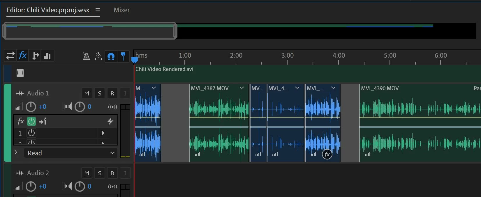

I'm editing audio that I brought into Audition from Premiere using the interchange. Throughout the process it has shown all my clips in the Multitrack view, and then I've been able to double-click each clip to edit it in Waveform view. I was working on a clip in Waveform when Audition crashed. It restarted in Multitrack view, and there are 2 clips missing. I checked the Temp folder on my main drive and there are no backups there. There is a backup folder within the Audition Interchange folder inside the Premiere Project folder, but all of those backups are also missing those same clips. And the clips are totally missing from the Multitrack, not like in Premiere when the clip is still on the Timeline and you can just click on it to relink it. How can I restore the session or just get those 2 clips back where they're supposed to be?

The clips are still in place in Premiere. I was thinking I could just send everything from Premiere to Audition again, but I'm pretty sure that would make me have to start all over in Audition. I really don't mind starting over on just those 2 clips, but is there a way to pull them over into this Audition session and retain the way I have it trimmed so I can plug them into the track?
